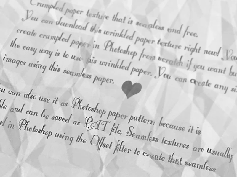

    If you want a result like this you have to use the Displace filter using a folded paper texture.
    Here are some useful tutorials on how to use the displacement map in Photoshop

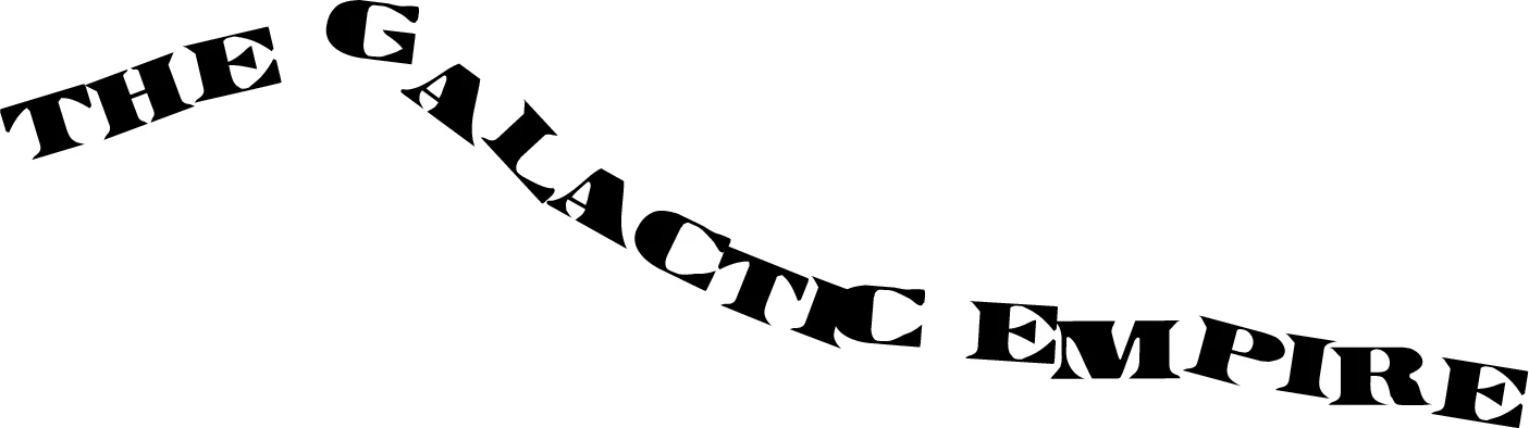

    First I created a path and then I put the text on it. This is just the text. It doesn't "fold" according to the path and no perspective (of course). Basically it doesn't look anywhere near to being printed on the paper. I have to change the perspective of the text and the letters have to follow the line and fold according to.
