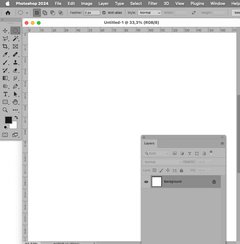

I dont know why but I always ran into error when trying to add shape
never ran into any problem when adding text, can someone help and send me a script to
"Draw an ellipse shape that have the position and radius of the selected layer"
ran into problem at ellipseLayer.kind = LayerKind.ELLIPSE;
