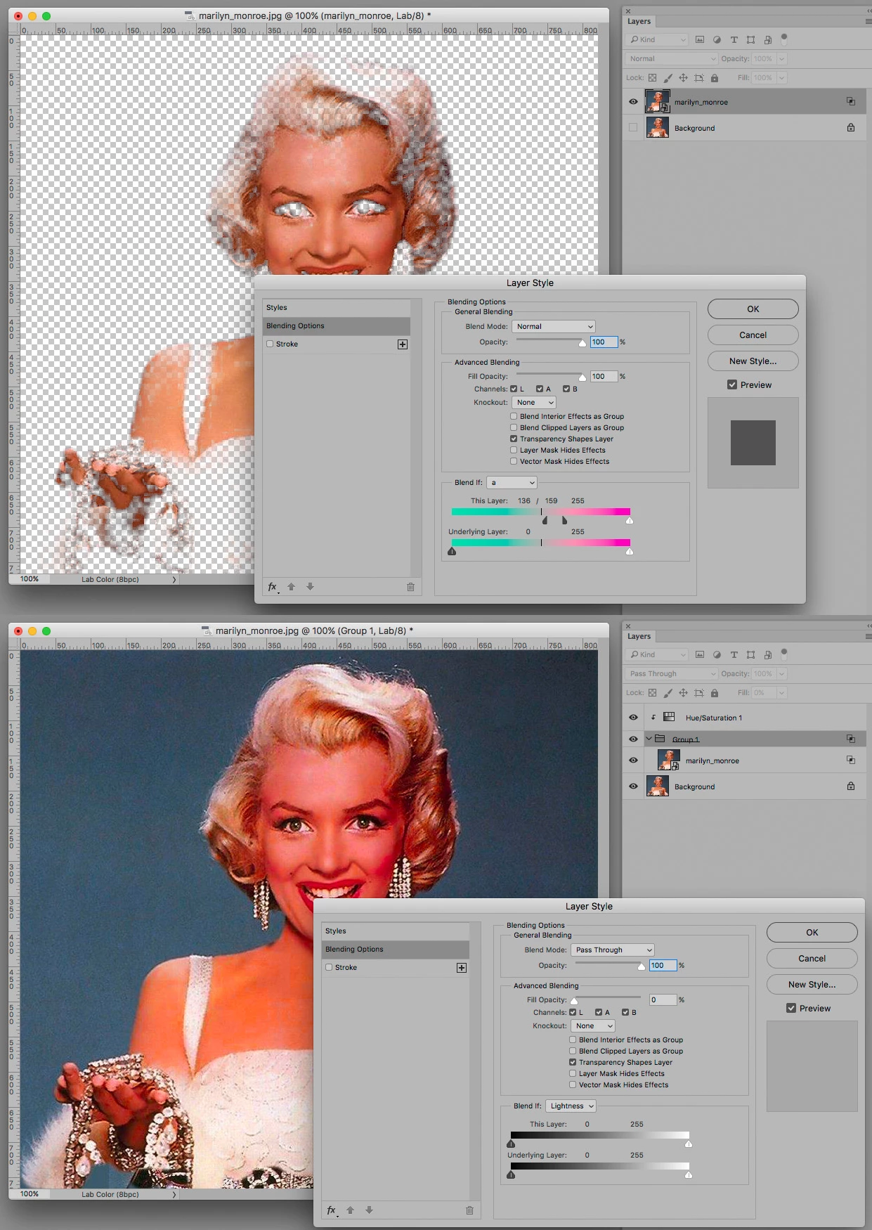

You could work in Lab.
There you might even be able to use Blend if settings of Smart Object instances as the basis of a Clipping Mask.

if I work in lab color in the channels I should find cmyk right?
I am not sure I understand what you mean.
Once I have selected and created a new level with that alpha channel when I need to convert them back to RGB I have to make a flatten.
One should avoid performing needless conversions.
If you indeed want to create a Layer Mask or Alpha Channel rather use a Lab duplicate than damaging the original image by converting it to Lab and back.
