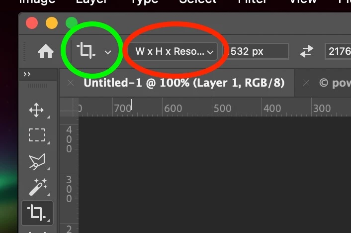

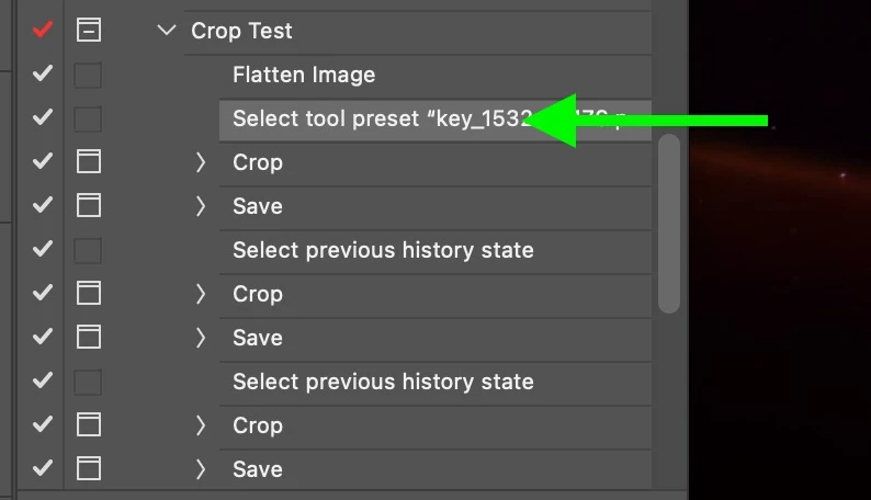

Wow - I thought I was using a crop tool preset in the action, but now I realize that selecting a preset in the red dropdown doesn't record as an action step, while selecting a preset in the green dropdown does!
Right above my usual crop step (which has the stop/confirm turned on) I recorded the step of selecting my first crop size from the green dropdown, without a stop. That worked perfectly, now the grid shows up regardless which tool was active when I start the action. Thank you, Stephen!!
Ah! Further appreciation for the images of your preset choice. I tried for half an hour this morning to get my action to record the crop tool by messing around with all manner of settings from the red circle but never thought to try the green one. Just added that in as you described and it seems we're back in business with the action! Thanks to all for your help.
