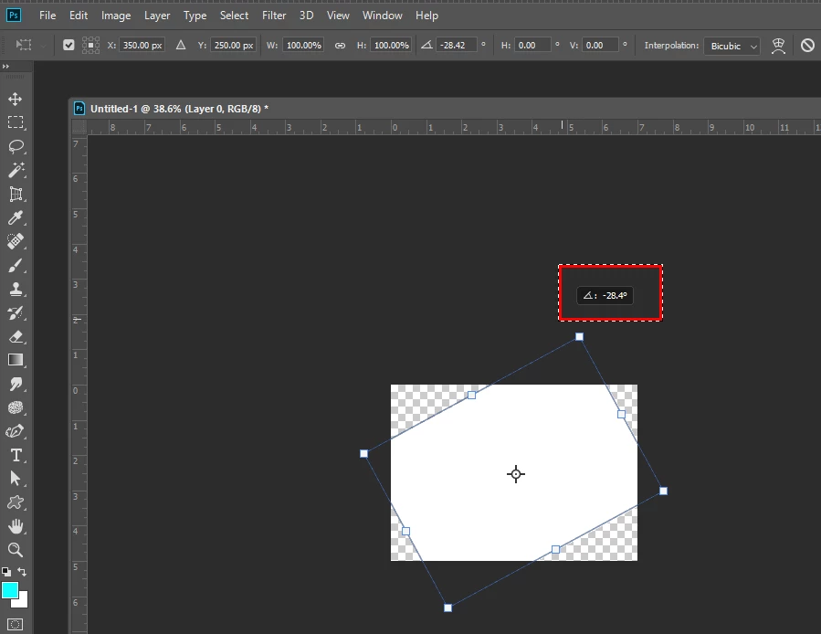

If you rotate a crop part will be off canvas.    If you convert the background layer to a normal layer you can use free transform and rotate using your mouse. or enter precis values in the tool option bar.
Using the mouse transform shows the precise angle on your display

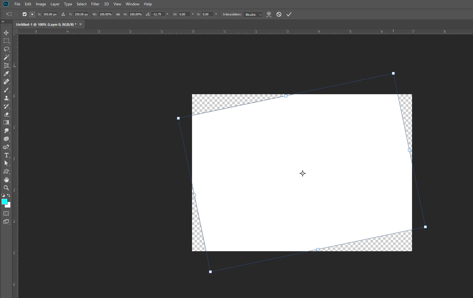

February 15, 2019
If you convert the background layer to a Smart Object, and have "Delete Cropped Pixels" un-checked in the Crop tool options, you can go back and forth between Crop and Transform, without worrying about the original being degraded.
