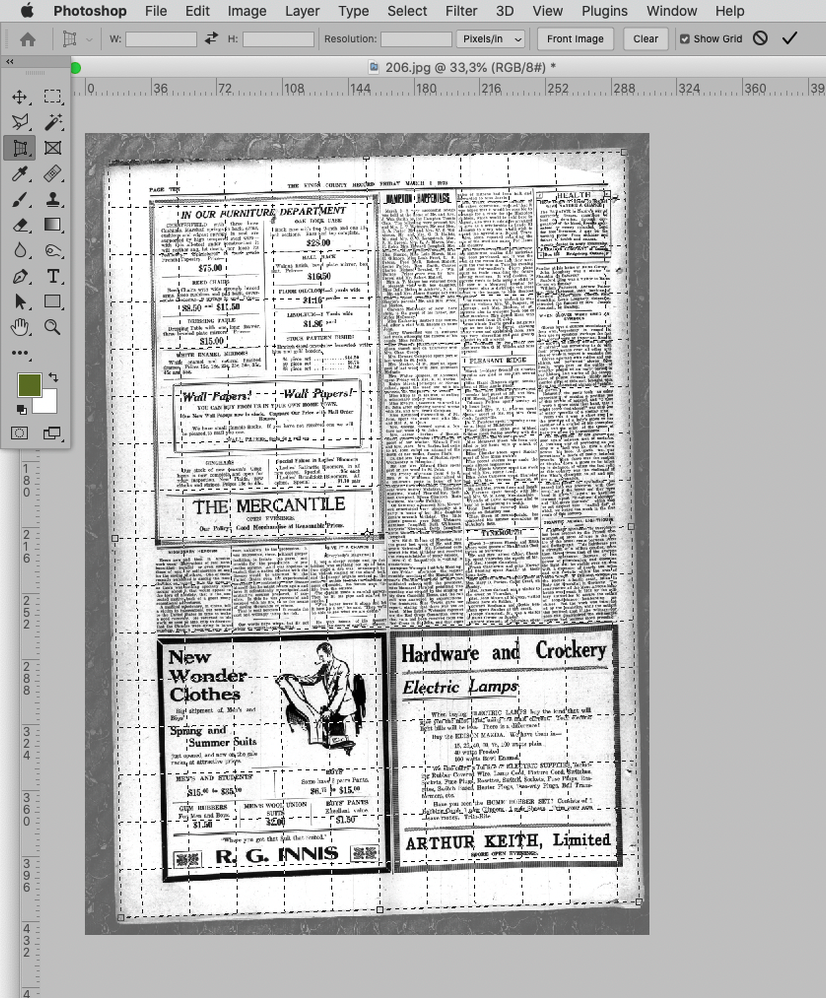

I have a year of scanned images, almost 600, of old newspapers that I want to crop & straighten. The script in PS does nothing to any of the images I have tried.
From a discussion elsewhere I have resorted to using Camera Raw filter > geomatry and the align vertical & horizantal tool. This works for most but for some reason the ones that are straight get rotated a few degrees and end up worse than the original.
If and when I get them straight what would be the best way to crop to the white newspaper edge.
I can't set any Crop tool presets, is this fixed yet?
Any ideas for a great workflow would be very appreciated.
Here is a sample image.
Thanks in advance.

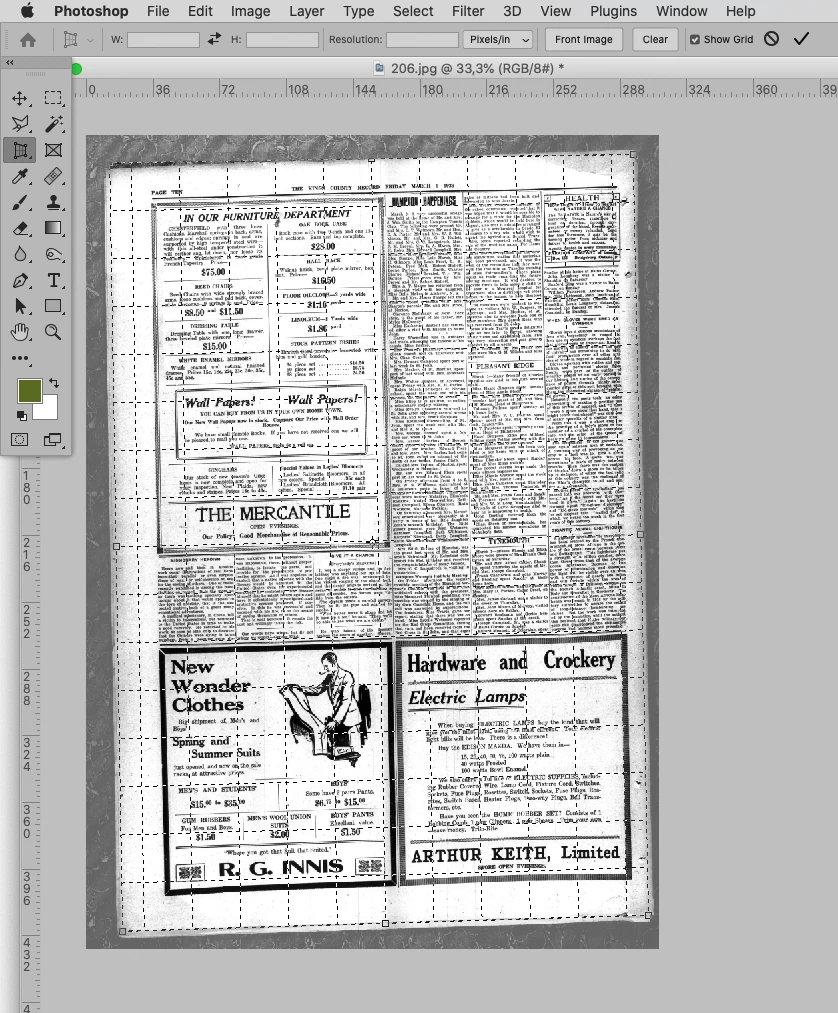

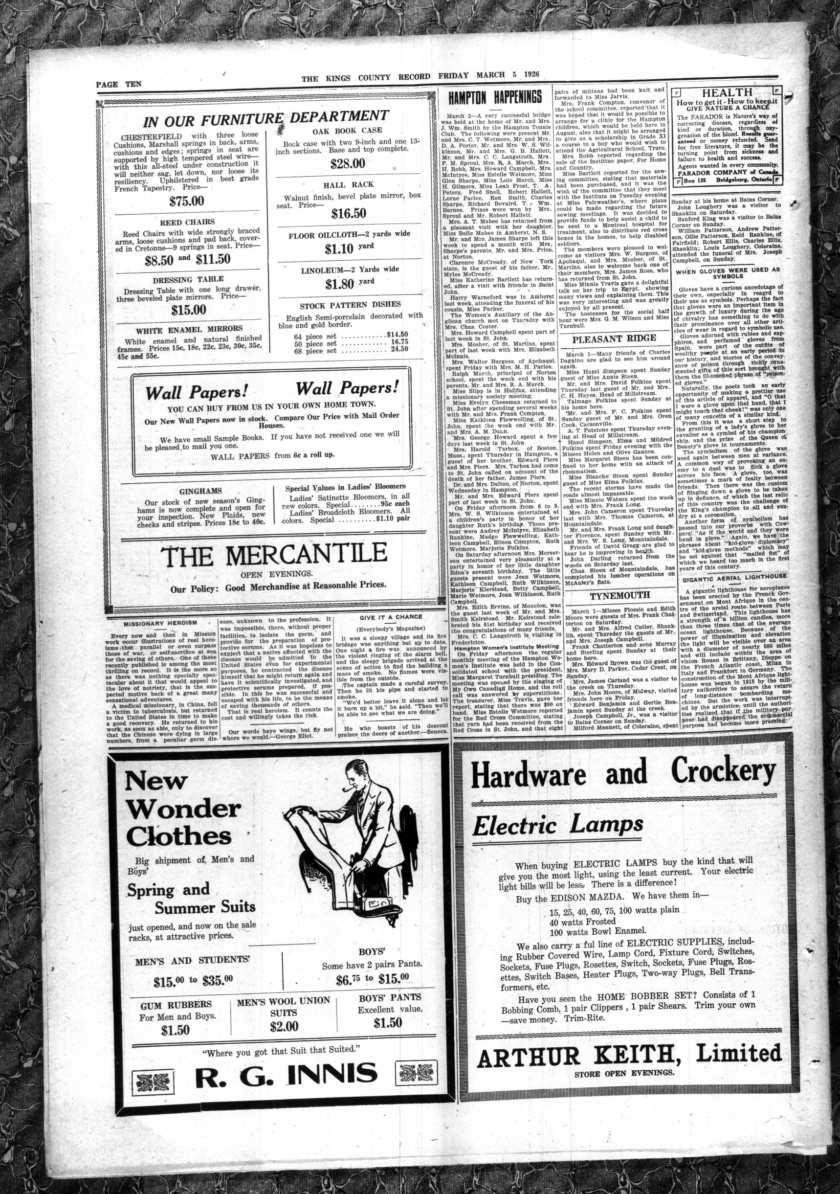

I like c.pfaffenbichler’s idea to use the Perspective Crop tool; it’s probably the next method you should try. You simply drag the tool rectangle corners to match the distorted newspaper’s corners, and when applied, it straightens all sides at once. See demo below.

In the future you (or whoever did them) may want to scan properly – so no striped backgrounds.
Actually I wonder is that is a scan at all or a photograph.
I suspect you may have to crop the files manually, possibly with the Perspective Crop Tool.

A potential problem with the Perspective Crop tool is that the customized crop rectangle can’t be saved as a preset, so you do have to do that manually for each of the almost 600 scans. If the distortions are consistent enough that a batch automation in Camera Filter takes less manual work, then maybe that is the best solution.
