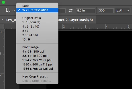

When I select the Crop Tool, I set the WxH.  I stretch the crop guide over the area I want, then crop it the image.  However, it does not crop it to the size I set.
For example, my image is 17" x 24" and I set the crop for 8.5" x 11".  I move the crop guide over the area I want to keep in the image, then I crop it.  Instead of the image being 8.5" x 11, the image size is 7" X 9".
Why isn't it cropping it down to the size I specified in the WxH fields?

I resolved my delima.  After selecting the Crop Tool, the WxH fields appear near the top.  To the left of the WxH fields is a dropdown.  It was defaulted to the Ratio option.  I changed the option to W x H x Resolution.  That option allowed me to crop the image properly.

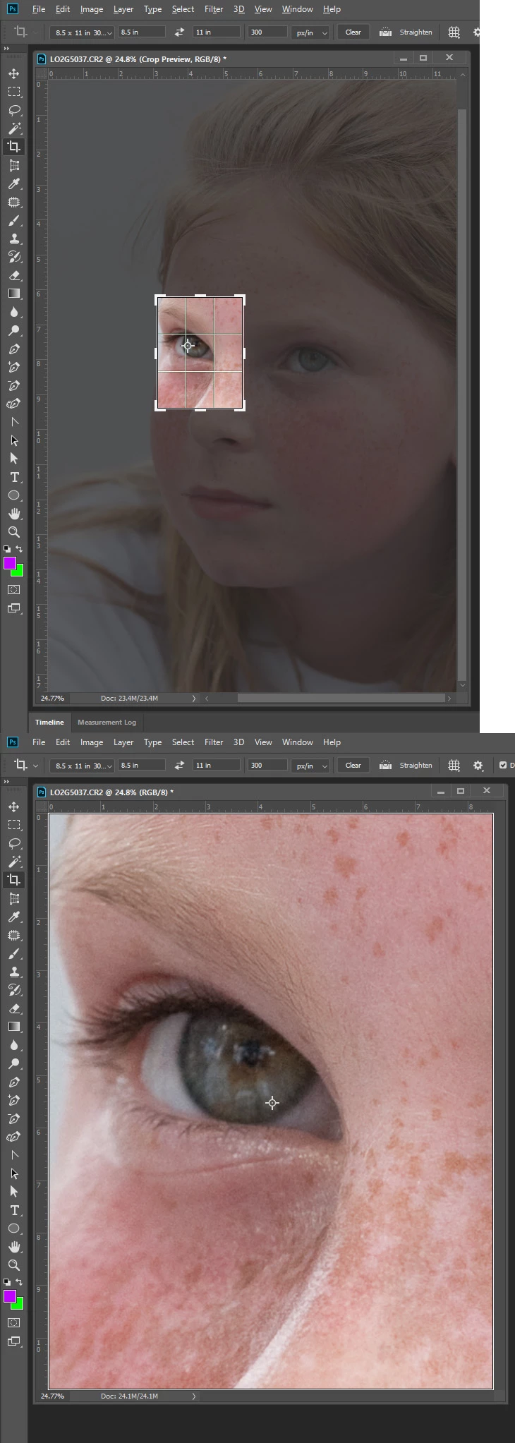

Can you post the screen captures that I requested.  I do not see your problem in CC 2019 version 20.0.6. The screen captures I posted were done using Photoshop CC 2019 version 20.0.6 on Windows 10 pro and worked correctly using inches.

Can you post screen capture of your cropping process with the  rulers visible and set to inches and the crop option tool bar visible. Two screen capture. One with the crop setup before you press enters to commit the crop. then After you press enter where the crop gets committed. For example like this:
