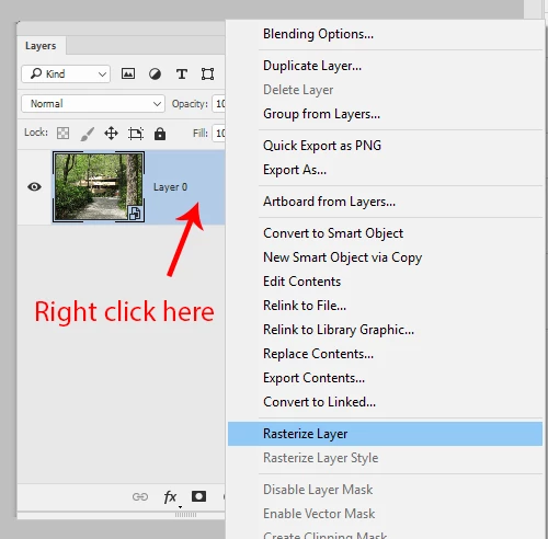

    Correct answer Jeff Arola
    Ah - yep, it does
    I guess the easiest thing to do in your case is Rasterize the Smart Object before cropping and then run the Spherize filter.
    Right click to the right of  the Smart Object Thumbnail in the layers panel and then click on Rasterize Layer.
    You can read about smart objects and smart filters here and see if that's something your interested in using.
    https://helpx.adobe.com/photoshop/using/create-smart-objects.html
    https://helpx.adobe.com/photoshop/using/applying-smart-filters.html#applying_smart_filters

    Does your layer have a symbol in the bottom right like in the screenshot below?
    If your unsure, you could post a screenshot of your layers panel.
