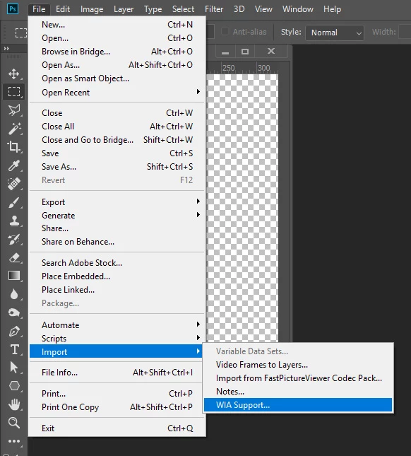

    You stated you imported a picure whad picture did you import and how which import feature?
    JJMack

    I didn't import, pardon, I just went
    File
    Open
    Desktop
    Grabbed a vector graphic jpeg
    Silkrooster
    February 3, 2018
    jpg's are not vector and they do not support transparency, Hence the background layer. Just drag padlock to trashcan as I mentioned above.
