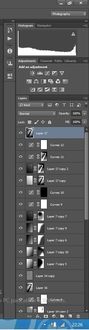

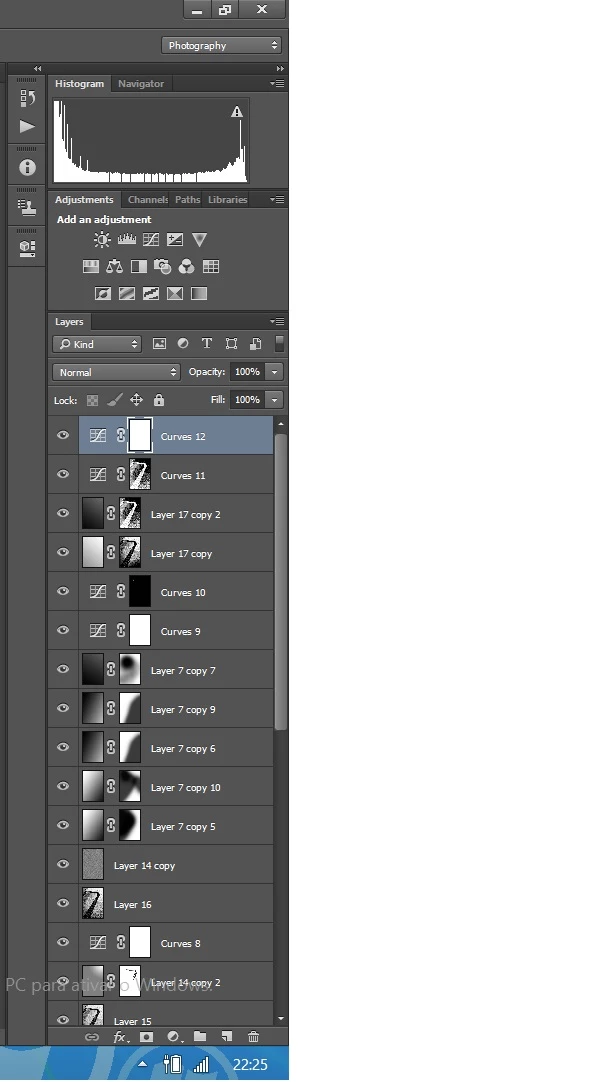

I would like to ask for your help.
the Ctrl+Alt+Shift+E shortcut is not working correctly on my PS CC2014 or CC2018.
I want to copy the merged all layers into a new layer, but the problem is that it creates a layer different from the one I see on screen....
In the left side picture you can see the histogram of the photo i've been woorking
In the right side picture i made the  Ctrl+Alt+Shift+E shortcut and we can see the changes in the histogram
Thanks a lot for your help,
Rui

October 24, 2018
Both Histograms have a warning triangle and I can not see from its palette  what the source its using. the two images posted look like the new top layer may have some pixels not 100% opaque so they blend with lower layers and change the composite image.

the source is "Entire Image"

October 24, 2018
Click on the Yellow Triangle for an Uncached view of the histogram before merging and then after merging and see those match.

D Fosse
October 24, 2018
You need to view at 100% - one image pixel represented by one screen pixel. Then they will match - just as histograms will match when you refresh it.
All adjustment previews are calculated on the basis of on-screen zoom ratio (for performance reasons).
If the image has noise, grain or other sharp pixel transitions, scaling will soften these sharp transitions and thus introduce intermediate pixel values that aren't there in the original. So you get an incorrect adjustment preview.
You must view at 100% for an accurate preview.
D Fosse
October 24, 2018
Update the histogram by clicking the !-triangle. Then they should match.
If you see visual differences, it's because you are not viewing at 100%.
