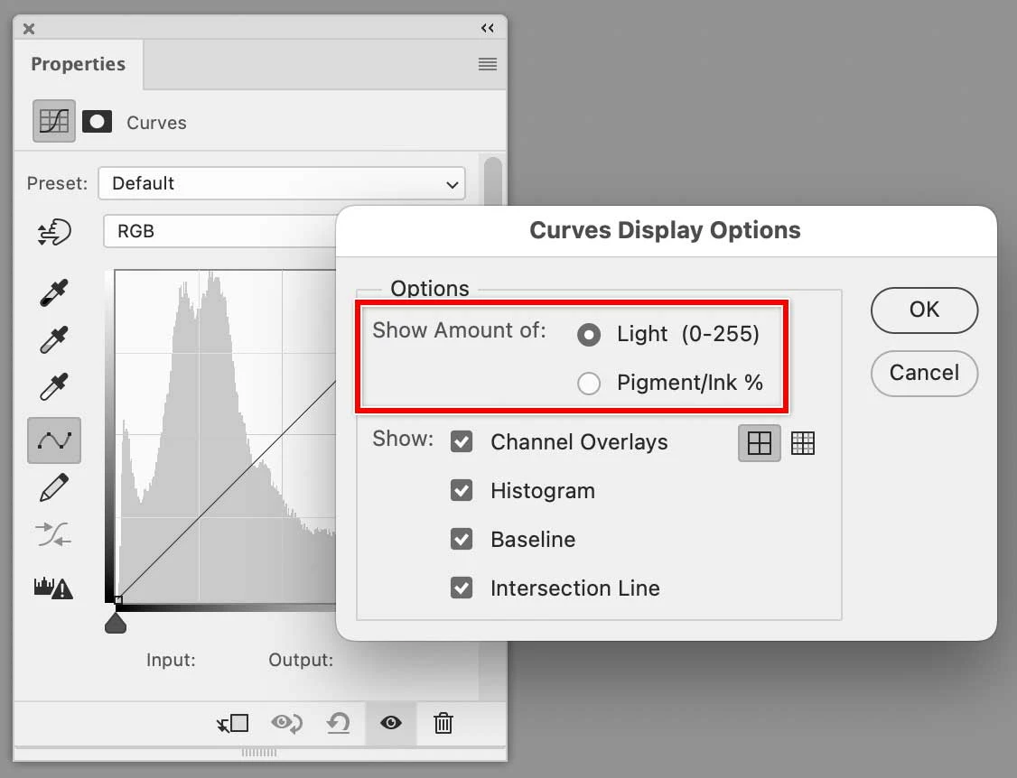

Correct answer Semaphoric
Look in the Properties panel menu, and select Curves Display Options. You apparently have Pigment/Ink % selected. Try changing it to Light (0-255)/
Semaphoric
SemaphoricCommunity ExpertCorrect answer
August 5, 2023

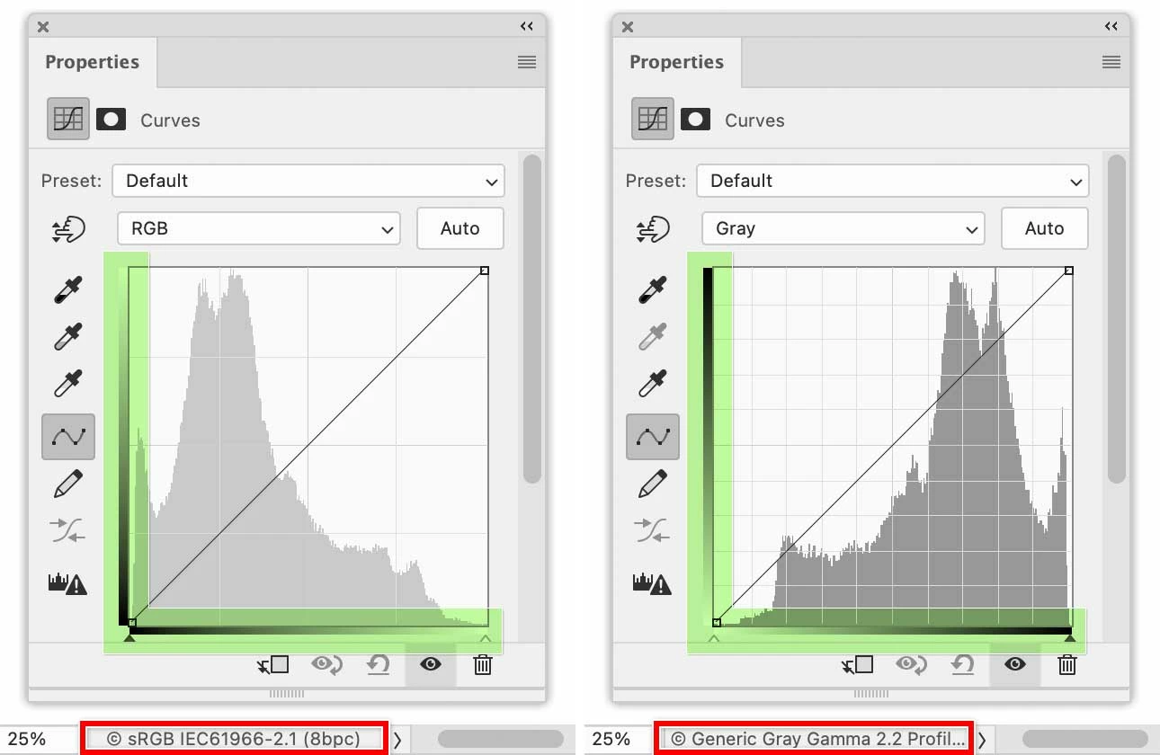

Conrad_C
August 5, 2023
In the posted screen shot, the menu above the Curves graph says Gray. I think that’s probably the explanation, and if it is, the graph is working as expected, and as Photoshop has worked since the 1990s.
How the Curves graph displays depends on whether the color mode is transmissive or reflective. In transmissive light modes such as RGB, 100% equals full brightness and all channels maxed out makes white, so in Curves, the top and right sides (maximum values) represent white. In reflective (print) modes such as CMYK and grayscale, 100% equals full ink coverage creating black, so in Curves, the top and right sides represent black.
Accordingly, the histogram inside the Curves graph appears follows the orientation of the tonal values. So in the picture below of the same image, when the image is gray (on the right), its histogram appears reversed compared to when it’s in RGB (left).
It looks like the Epson software was probably set to save the scans in a gray color mode, so Photoshop uses the “100% equals solid black” graph in Curves. If you converted it to an RGB color space or had the Epson scan software save them in RGB, the graph would invert to the transmissive model that you might be more used to.
Lightroom always uses an transmissive light graph, because it does not support ink-referred color modes (you can’t edit in CMYK or gray).

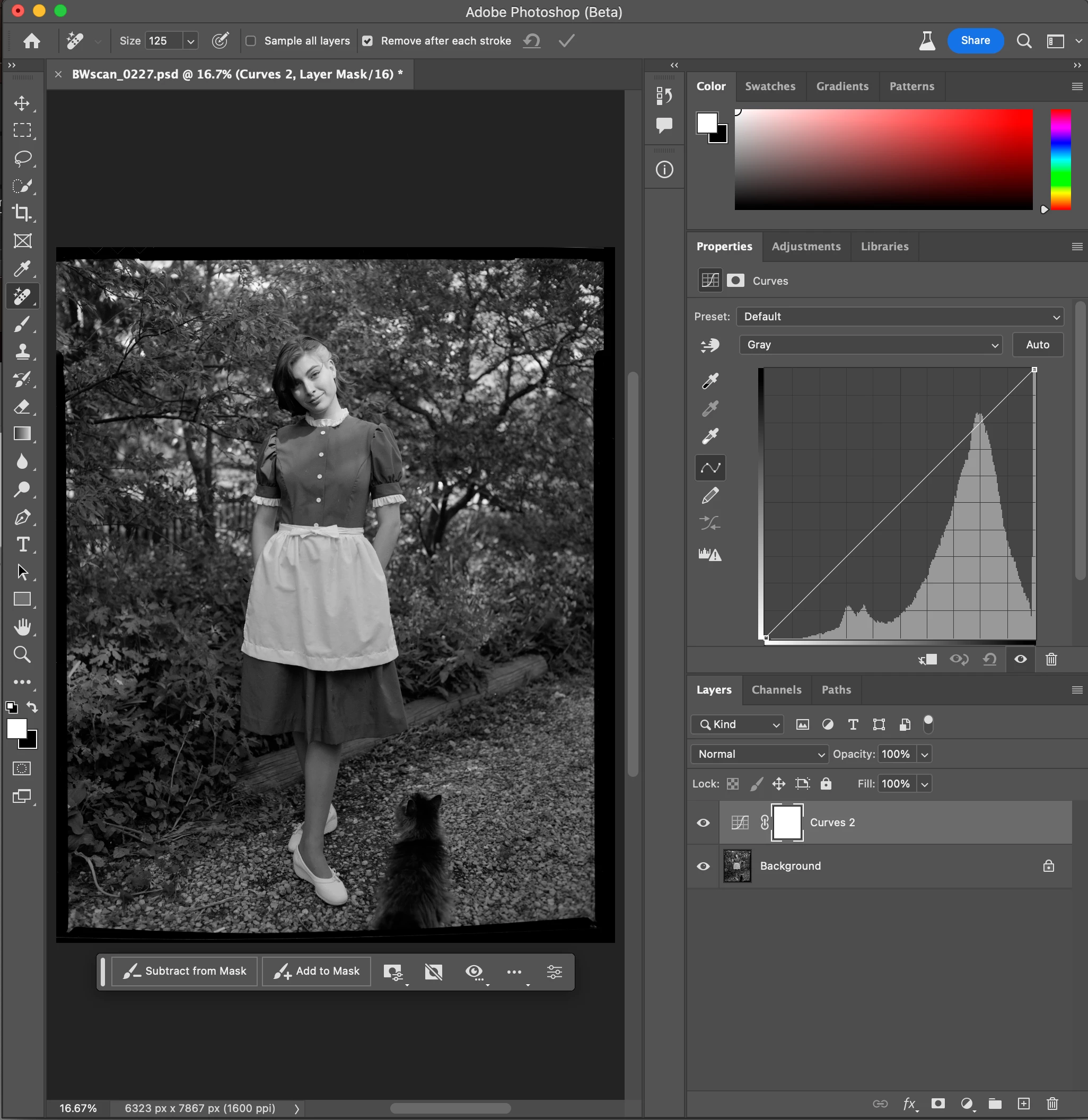

davescm
August 4, 2023
Can you post a screenshot including the image , the properties panel and the curve display. Also please confirm your image mode.
Dave
lloyd_pdxAuthor
August 4, 2023
Thanks, Dave:
Grayscale 16bit
I assume you wanted the properties panel with curve displayed?
