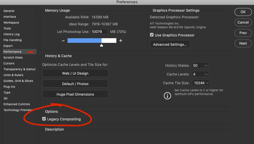

Try turning back on LEGACY compositing in Preferences.

Thanks very much for the suggestion. Unfortunately, the screen I get when I
go to preferences - performance does not include the choice that is circled
on your screen shot. The rest of the screen appears to be the same.
