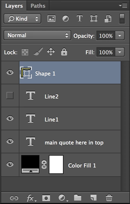

I have changed your text layers to use “centred” aligned text, not left and then aligned the text objects to the centre of the canvas. This is because the script that resizes to a preset pixel dimension will resize from the centre of the targeted layer. You will hopefully see what I mean when you compare the template that I will shortly upload to your original template.
At the moment, all of your artwork could potentially benefit from being produced via text/vectors, so I would also recommend creating the yellow bar out of a vector shape layer using the vector rectangle tool (U):

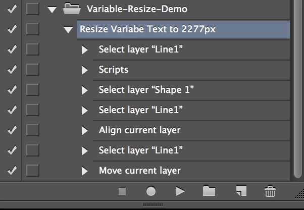

I will shortly upload a script and action set to my DropBox, as well as a revised PSD template etc.
I have uploaded a .zip archive:
https://www.dropbox.com/s/bejqr2p2g3rdrk2/ps-variable-demo.zip
Contents:
* dataset.csv = simple test data source file
* demo-test.psd = Photoshop file for test export
* Resize layer to 2277px.jsx = Script to resize targeted layer content to 2277px wide
* Variable-Resize-Demo.atn = Action file that references the script with other steps
There are also two folders:
* Export to Datasets = Original export of data sets x2 .psd files
* Action Output = Batch action output resize results x2 .psd files

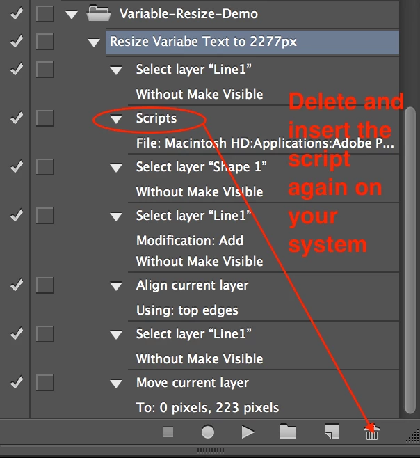

1) As the action has the install location of the script on my system, you will need to delete the action step “Scripts” and insert the action into the script using your scripts installed location.
After dragging the ”scripts” action step to the trash icon in the actions window, use the actions window’s options menu to “insert menu item”, then select the file menu/scripts/Resize layer to 2277px
Ensure that the script steps appear in the same order as the image in my previous post.

1) Setup a File/Automate/Batch similar to the image in my previous post.
If everything is setup correctly, then you should find that the results of the data set export have been resized to match the width of the yellow graphic.
You will need to edit or create separate actions to handle different variable text layers, this sample only targets the specific text layer “Line1”.
