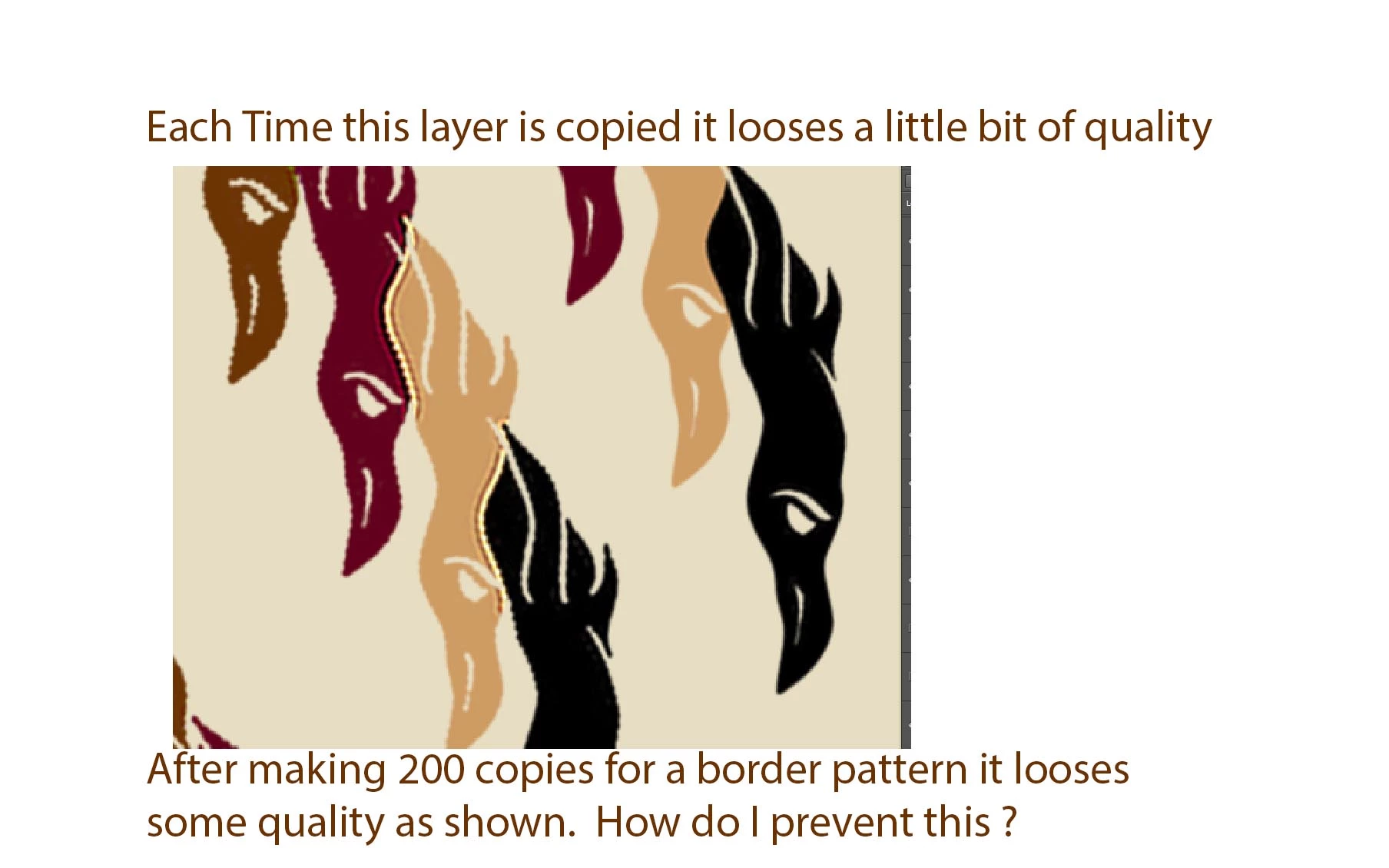

Did you know that when you copy a layer it looses quality ?
  • March 27, 2018
  • 4 replies
  • 4715 views
So after 800 copies can you imagine what this would look like.   My actual question is how do I prevent quality loss ?     Going back to the original layer and placing it in the right location and then doing  a layer duplication would not be the right answer for me.
I personally am fascinated by this topic and hope to learn something new about Photoshop.

    You're not merely copying layers here, you're resaving. That looks like a serious case of cumulative jpeg artifacts. Repeated resaving over itself to jpeg will look like this.
    As Dave correctly shows, layer copying changes no data. But resaving to jpeg does.
    Jpeg is a horrible format for almost everything. Don't work with jpeg and never resave a jpeg if it can be avoided. The only sensible use for jpeg is final delivery/transport to save bandwidth. For everything else, stay away from jpeg.
    EDIT: I suppose it could also look like this after 200 iterations of Unsharp Mask at very aggressive settings. But jpeg compression is more likely.
    March 28, 2018
    ITs not a JPG.   I have not read about or understood smart objects and I hope this is a solution.
    I am taking a layer. and duplicating it with adobe Actions. Repetitively it copies the last layer that was just copied.   I am using Photoshop 2015.
    It has done this on a few different objects.  After its copied it looses a tiny bit.     what I am doing now is copying it 100 times then I go back to the original layer I began with and replace it. then copy on more.

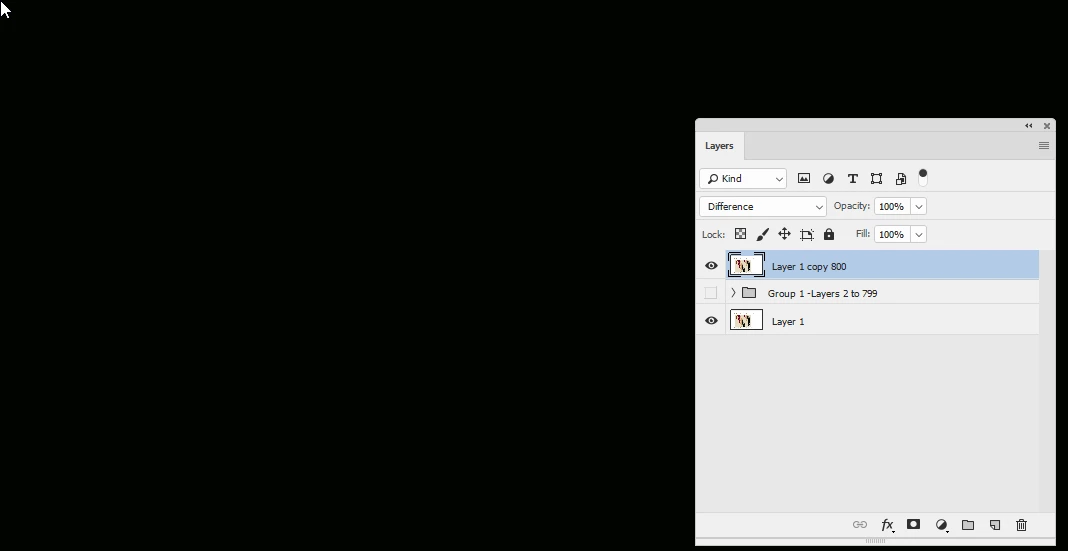

    So I just took your image and duplicated the layer 800 times. Each duplication used Ctrl+J and was a duplicate of the last
    I then grouped the intermediate layers and turned visibility off
    Finally I set Layer 800 to Difference blending mode so that any difference between the original and the 800th copy would be visible.
    Result : Every pixel is black (RGB 0,0,0) i.e.  there is no difference at all between the original and the 800th copy
    I am interested to learn more about your layers and process to see where any error might be creeping in
    Dave
