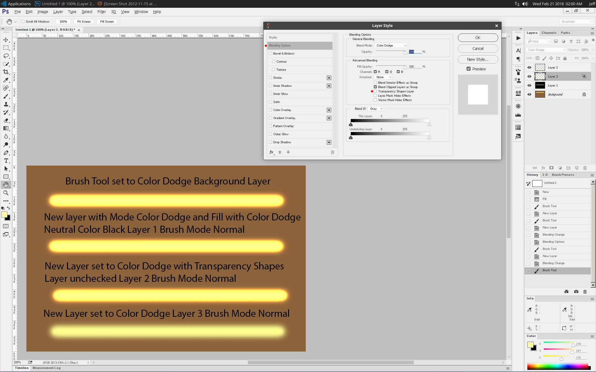

Used color dodge on both brush and layer and results will come out different? why?
i'd much prefer to use layer but it just doesn't have the same effect
the pic on the left is by changing the brush mode to color dodge
the right is by opening up a new layer then change the layer to color dodge
to sum it all up: what can i do to achieve the left picture's result with layer modes so that it doesn't end up like the one on the right?

This should work to get the same results on a blank layer:

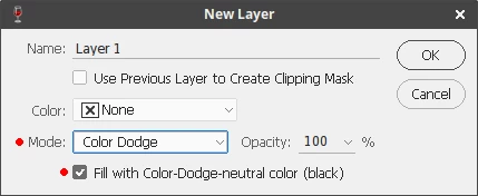

Layer>New>Layer set Mode to Color Dodge and check Fill with Color Dodge Neutral Color (black).
Set the brush mode to normal and then paint on that layer.
or
Make a new blank layer, set the Blend Mode to Color Dodge, go to Blending Options in the Layer Styles dialog and uncheck Transparency Shapes Layer
Why the differences seems to be a story in itself.

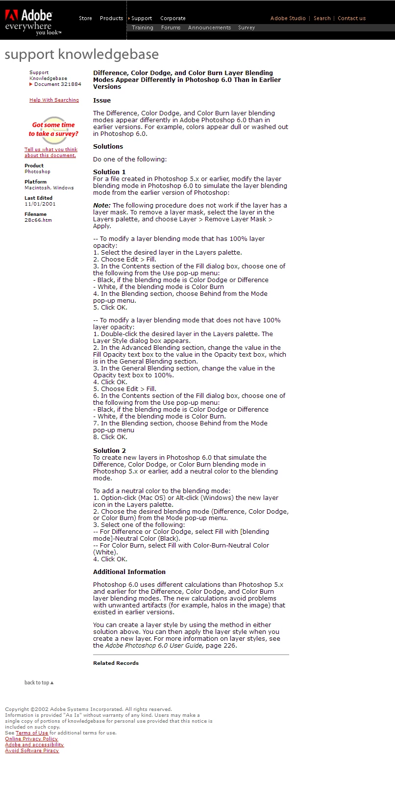

Photoshop 4 thru 5.5 used Color Dodge and Color Burn the same on transparent layers as painting on a layer with the brush mode set to Color Dodge or Color Burn.
Then in photoshop 6 there were changes to the way Difference, Color Dodge and Color Burn layer blend modes were applied to layers, which was different than the previous way apparently, so thus the differences you noticed between brush color dodge and layer color dodge and the workarounds listed above to mimic the old way.
Here's an old post on it that has a link to a now defunct KB about it.
Photoshop 6 and the change in Color Dodge/Burn blend modes
Here's the KB if you want to read it:
