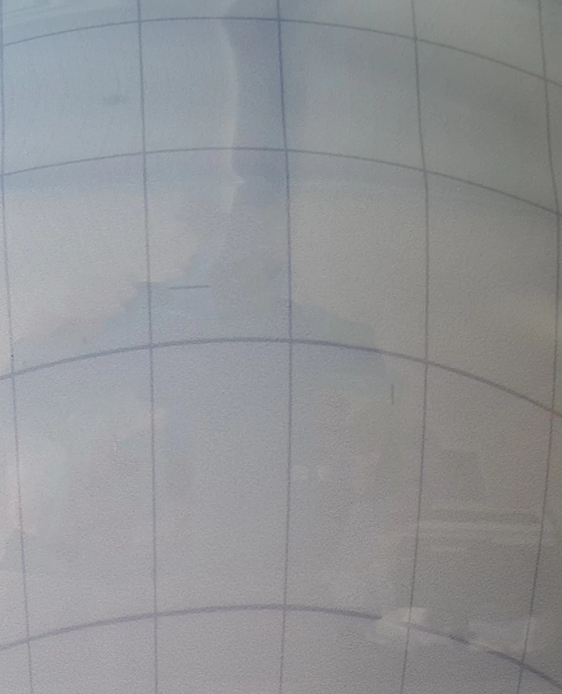

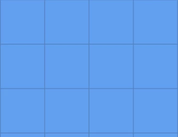

I'm banging my head against the wall, I can not figure out how to fix my problem.
I got a small business/hobby printing and vacuumforming the print around objects.
There is software for my problem, but it is way to expensive. (https://www.youtube.com/watch?v=ulT0LqQ9KHE)
I have printed numerous patterns to check how much my images distorts, and its from 0 - 300%.
That meaning someplaces, a 1x1cm square will be 1x3cm when formed.
Anybody got a bright idea how to fix this problem ?
I'l add two images as examples.

I don't have any solutions at this time, but have started to work on the problem using methods described in this paper:
https://igl.ethz.ch/projects/thermoforming/computational-thermoforming-2016.pdf  I spoke to one of the authors at NYU and wrote some code in Mathematica.  The idea is to print the grid, thermoform, scan the formed object from above, and compute the anti-distortion.  That is then used to distort the original graphic.  Even using commercial software, it is an iterative process, and usually takes a few tries before the distortion is exact.
