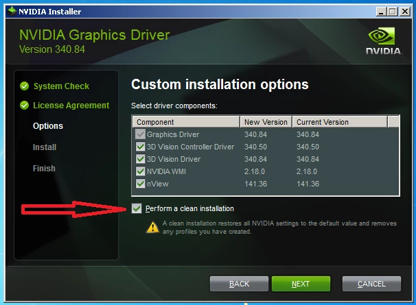

In addition to Ged's suggestion of a clean install, I'd also strongly recommend unchecking all the additional components in the installer. You don't need any of them, all you need is the base driver.

October 18, 2018
Hi
Try downloading the diver from here and perform a clean install
Download Drivers | NVIDIA
Also take a look here
Troubleshoot Photoshop graphics processor (GPU) and graphics driver issues
Can you post your Photoshop system info, go to Help > System Info and copy and paste that into this thread
