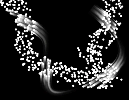

For the trails you could made a duplicate layer set to Screen mode, and stroke a path on it with the Smudge tool:
It takes a bit of experimenting to get the settings for Smudge just right, and you'll probably need to do the stroke several times in a row to build up the effect. In the example above, I did the stroke six times.

To ensure the direction stays the same for multiple strokes one could create a Path and use »Stroke Path« with the Smudge Tool, but quite likely that is so un-spontaneous that it would not offer a relevant advantage.
Semaphoric
February 4, 2019
That's exactly what I did.Just plan what you are doing, set up the necessary tools, and tweak until the desired effect is achieved.
