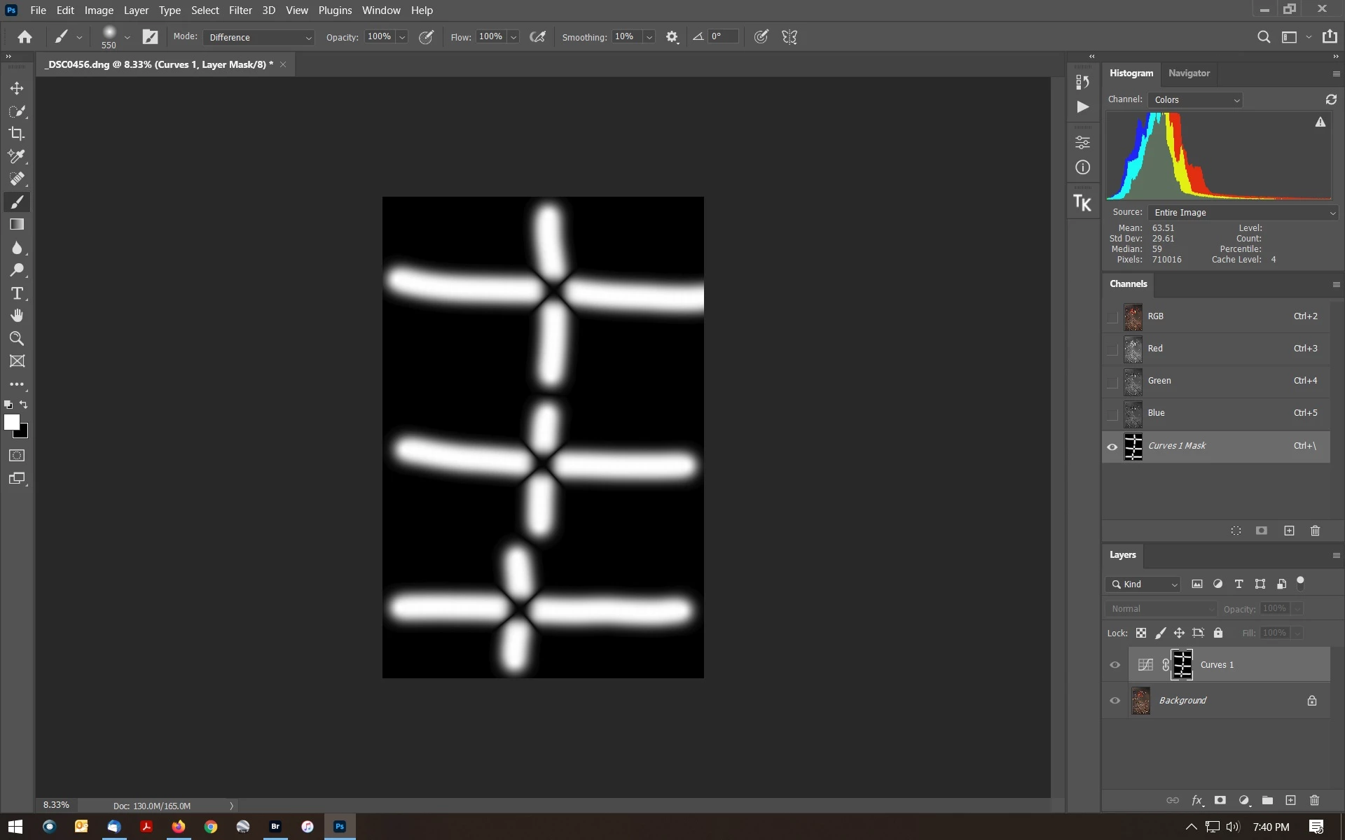

Ok, I opened an image and then added a curves layer. On PC if you ALT/Click you can see just the mask as shown here.
If you look I was using a white brush at 100% opacity (so you can see what I mean.....).  I did three crosses. Normally these would appear as completely white.  But check it out!  Where they intersect the white brush turns black momentarily and "pushes" the white out of the way.  Extremely difficult to explain in words!
