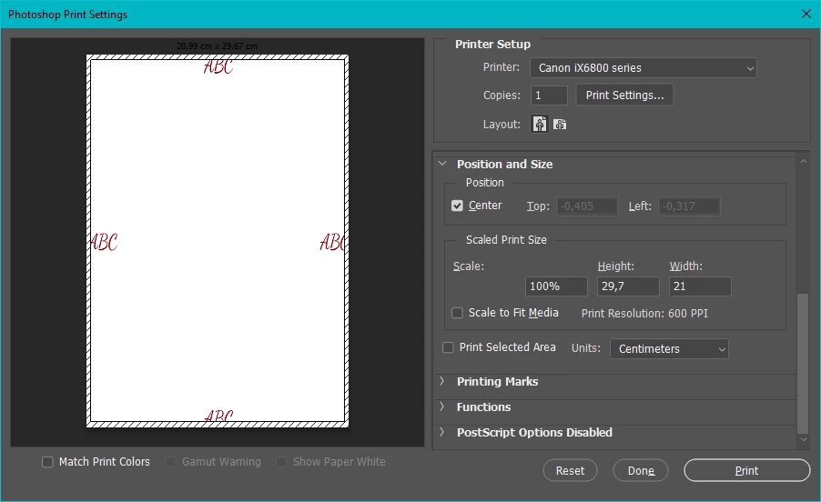

Thank you for all your responds, yes, I use this setting for other types of prints, but this is a little bit different situation, it is not a classical poster, it is an illustration for riso graph, but curently it is necessary to prepare it just for the samle, on standard home printer, without any bleed and crop marks, just like standard document, the requierement was 600 dpi, rgb, A4, but when i try to print it, there are problems, the sample is cropped on some sides. I am enclosing the preview.

as you need it to be A4 you need to make sure that your image size is set to mm not pixels 210x297 in this case. I am presuming that your printer is not the issue. A normal desktop printer even if set not to scale page will still not be able to print to the edge thus creating narrow white margins
/G

Yes, I check out mm, they are okey, but when I print from Photoshop, I tried various settings, but still the some part is cropped, at the left side or at the right side.

Please upload relevent screenshots namely:
Image size UI dialogue
Output UI D
also What printer is it? What paper size are you using (as printing on 100% on A3 and trimming for eg)
