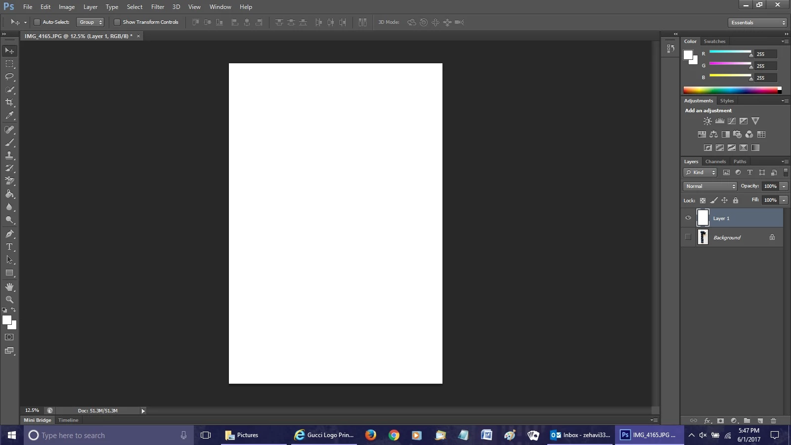

    I'm going to guess that your bottom layer is a background layer and not a regular layer. You need to unlock the background layer and turn it into a regular layer - in CS6, you can drag the lock icon to the trashcan... If this is not the case, post a screenshot of layers....

    June 2, 2017
    Thank you for your prompt reply! Here are the requested screenshots:
