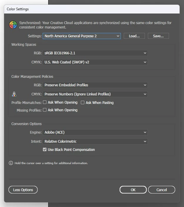

I'm suddenly having an issue where the colors in all of the Adobe programs I use (Photoshop, Illustrator, and InDesign) are dull and washed out. The only program that seems to display the colors correctly is Acrobat. I work almost exclusively in CMYK because my work is all print work.
I have not changed any settings and I checked to make sure my color settings were the same as they have always been: North America General Purpose 2. It also says that setting is synchronized across CC programs.
I believe this is a bug on how the programs are just displaying the colors because all of my settings seem correct and the colors are the same ones I've used before, they just look duller. I can simply save a file out of Photoshop or Illustrator as a PDF, and it displays perfectly when opened with Acrobat. I also haven't had an issue with the colors once they are printed.
I've tried a few fixes I found while searching online, like resetting colors in Bridge (which I never use), turning off the GPU performance, and updating or reverting the programs to different versions. All to no avail. All programs are currently up to date, but the problem persists. Any suggestions?

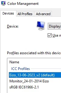

[Win 10] I've had a similar [cursing removed] some days ago after calibration, so calibration is not the magic trick...
A red car would look orange in PS.
Whatever I did did not fix it, or only for seconds.
There are many reports about this on the internet. Anything I tried didn't work.
What eventually worked is to keep at least two profiles in this view. I first added the sRGB, then my new and a previous one I know had worked. If I select the correct one last (and set as default), it sticks and looks correct. Should I remove the other two or the sRGB, I'm probably[cursing removed] again, which doesn't make sense.

What calibrator are you using? You should normally not need to go into that Windows dialog at all, much less "add" any profiles. The calibrator will set it all up - if it doesn't, it's not working.
If you do go in to check, only one profile needs to be there, and that's the one describing the actual and current response of the monitor. The profile is a map, and like any map it needs to describe the actual terrain.
Most problems people get with calibration, is that they do something when they shouldn't.
Note that if the profile is changed on system level, you have to relaunch Photoshop. It loads the profile at application startup, and keeps using that profile for the remainder of the session.

To find out if the monitor display profile is the issue, I recommend you to try temporarily setting the monitor profile for your own monitor display under “Device” in your Windows ‘color management’ control panel to “sRGB IEC61966-2.1”. (If you have a wide gamut monitor display (check the spec online) it’s better to try ‘AdobeRGB1998” here instead as it more closely approximates the display characteristics).
Click ‘Start’, type color in the search box,
then click Color Management.
[or Press the Windows key + R, type colorcpl in the box and press Enter]
In the Devices tab, ensure that your monitor is selected in the Device field.
You can click to ADD to add “sRGB IEC61966-2.1” (or AdobeRGB1998) if not already listed there.
Again - IF you have a wide gamut display I suggest trying “AdobeRGB1998”
Once it’s selected, be sure to check “Use my settings for this device” up top.
And click on “set as Default Profile - bottom right
Screenshot of Color Management Control Panel
Quit and relaunch Photoshop after the control panel change, to ensure the new settings are applied.
