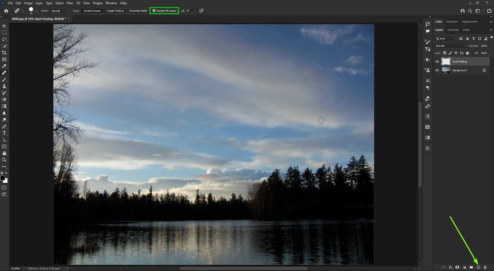

Ged_Traynor
December 3, 2021
Hi
No need to duplicate the layer, just create a new layer and with the Spot Healing Brush selected, enable Sample All Layers on the options bar, you can work non destructively on the new layer and create as many new layers as you need
