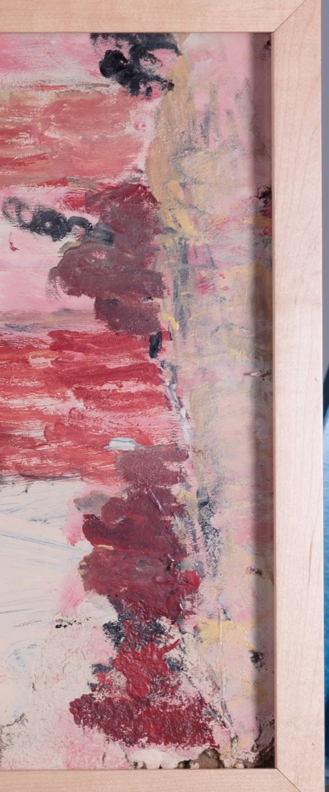

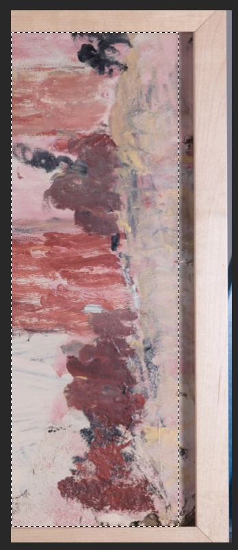

I shot a painting, and can't get the shadow from my lighting off of it.  There was no way around it on site, just wondering if anyone can help me figure out how to do it in post.  No matter how I do it I get a line from the shadow.

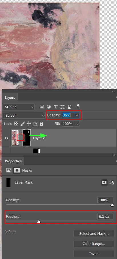

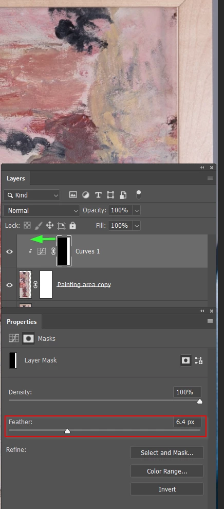

    The approach I take in that sort of situation is to use a hard edged layer mask in a Curves layer.
    I then ignore the obvious seam while adjusting the curve, and go just a bit too far.
    (If this happening with a raster layer, I unlink the mask so I can move it independently of the layer's contents)
    I use Mask Properties to adjust the feather, and move the mask left and right.
    And use either the density slider in mask properties, or reduce the layer opacity to lessen the effect (if still talking about a curves layer).
    This has the advantage of being non destructive and infinitely adjustable to fine tune

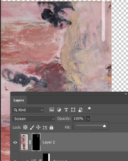

    What I've done here is add a copy merged layer to the top of the stack, and set it to Screen.
    Then added a hide all layer mask, and run a soft white brush down the slightly darker bit
    I've now lowered the layer opacity
    Unlinked and feathered the mask
    And nudged it to the right
    You can free transform a layer mask independently of the layer contents, which let my widen the mask a touch
    Or I could hold down Shift, and run a soft white brush down the mask to slightly widen the reveal area
    I can see it is a bit bright towards the bottom of the reveal area.  We already have a mask, but if we made the layer a Smart Object we could add a new layer mask, and run a black to transparent gradient up it.

    Anyway, to fix this particular situation, then as Nancy and Chuck have said, sacrifice the shadow area.
    There are any number of approaches. Quick and dirty would be to select the good area of the artwork
    And stretch it with Free Transform to cover the shadow area

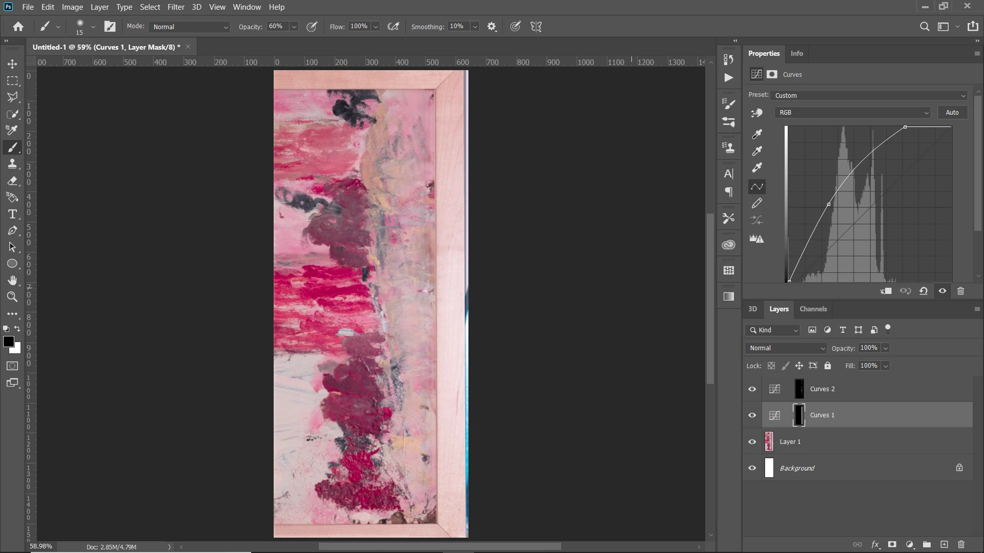

    June 20, 2019

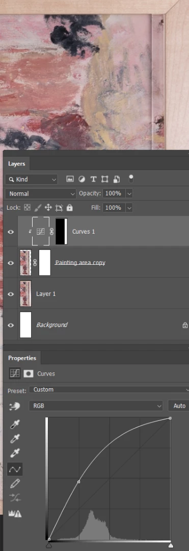

    I would agree with Nancy about removing the canvas, or taking several photos and move the lights around, so that you can fill in the dark area and blend the exposures. But if you have to work with this image, you can use curves and very carefully mask in the corrections.
    SRPcashieAuthor
    June 21, 2019
    This looks pretty good.  How did you get curves to get you this?  Did you do two separate adjustments?
    Chuck Uebele
    June 21, 2019
    I just used the polygon lasso tool to make a selection down the line, the feathers it. I tried to make the dark area the same as the light area. The transition was an issue, so first tried just to get the areas further from the transition to look close. Then I went back with a soft. Rush and touched up the transition. There was still a grayish line in the transition, so I added the second  curves layer to lighten it and add a bit of yellow red to that area, and then painted in the correction on a mask.
