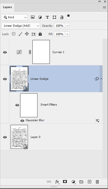

The difficulty is removing the unwanted marks whilst keeping the small wanted marks such as staccato dots or slurs. To Photoshop both are just white or black pixels.
The best I could achieve was duplicating the image, blurring it slightly and using Linear Dodge blend mode. Then adding a curve to restore some contrast.
