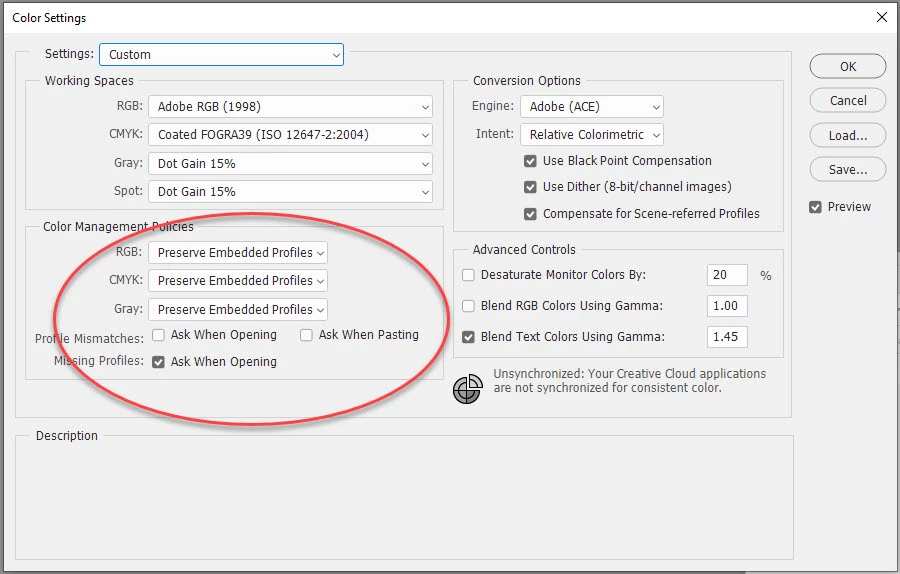

davescm
September 13, 2019
It's just a warning that the embedded profile is different to your Photoshop default. You can safely turn it off in Color Settings as long as you have the policies set to Preserve Embedded Profiles
Dave
Jitkacz
JitkaczAuthor
September 17, 2019
Thank you very much for your reply Dave! My settings looks different in many things, so if I change it to this one I shouldn´t get the notification any more. Anyway, I shouldn´t be worried about converted JPG color profile for those already edited and save as well?
