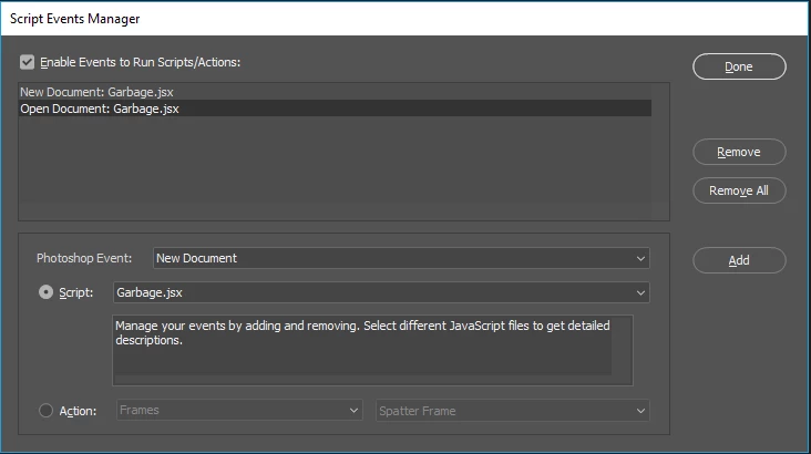

There are two kinds of stops in Actions.   Stop and Stops with continue.  Both can stop the playing of the action and leave the Action position to start playing at the next step in the action after the stop step.  You can do anytime you want in Photoshop and when done click play to continue the action.  The difference between the two stops is the if you juste wanted to put our a message to the user Stop with conduce allows the user to just to acknowledge that they saw the mess by pressing enter and the action continues. That is like an alert in a script.  There is no concept stop in scripting where a script can be started from a different step.  You would need to program the script with some logic that would know what part of the script to run each time you run it.   I use the document metadata instruction field to record that information.  The first my scripts of this type does is look to see what it has recorded there. If it finds none of its recordings in there it know it the first time the script is being run on this document to do its stuff. So it runs part 1 which notes in the instruction field its information and ends execution which could be a message to the user to do something and run the script again.  The next time the script is run on the document the script will rune the next part. If part is the last part all of the scripts information will be removed from the instruction field and the scrip will end execution.  The  allows the full process  be done more the one time on a document.
My script all use the instruction field and do not interfere with each be preserving data in the field which is not theirs.    My scripts for the most part do not put out message and the user does not know they are using the script more than one.  Most of my scripts of the scripts of this type I have were written for use within Actions or toggle function for documents.   They are more or less like save and restore steps for action   One may save the resolution and ruler in use for the Document  in the instruction field. Than action  is free to  scale the document to a known size without reapplying. The resize a watermark for this size document or select a font size for this size document  add the text or watermark then run the script a second time to restore the document resolution  scale it back to it original scale..
However Adobe added a bug into scripting in CC 2015.5 and will not allow  you to set the instruction files back to null if it were null to begin with. So I set up script event manager new document and open document event to add garbage to the instruction field if it is not in there so the field will not be null.
