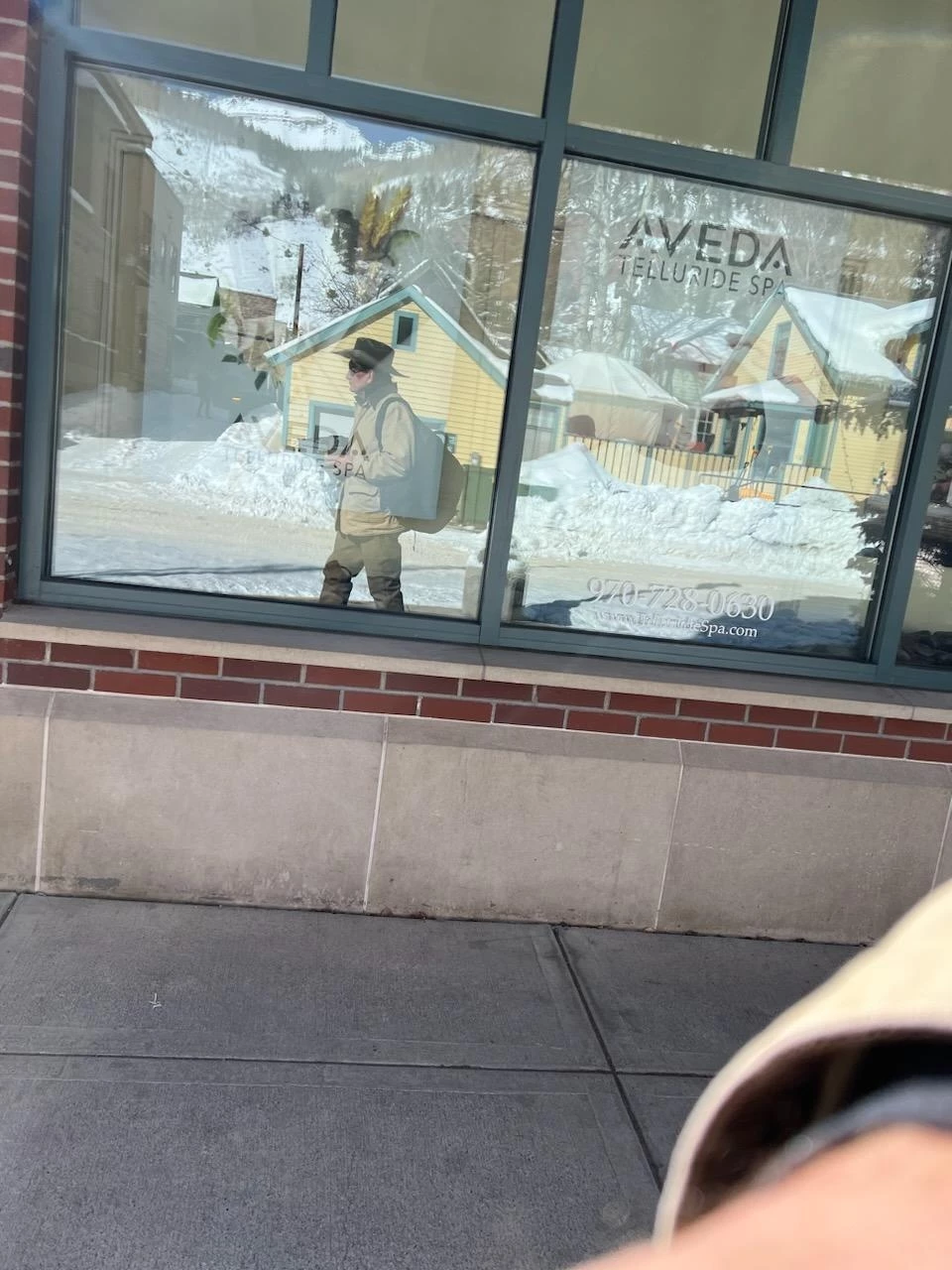

The image was taken by a friend as he was passing a business. I want to enhance everything on the outside of the window, and make everything on the other side of the window, less dominant.

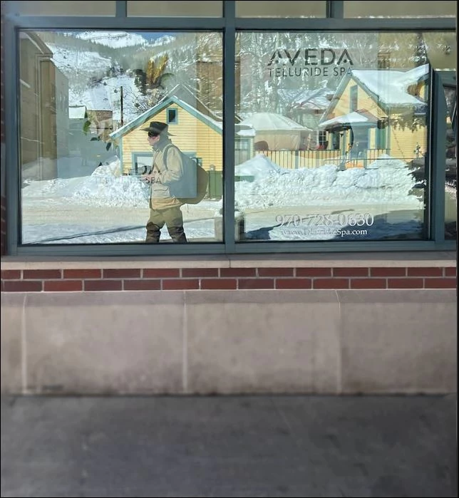

Just to clarify - you want to make anything in the foreground of the shot blurred & only have everything that's reflected in the glass sharp. Is that correct?
Here are some options - after straightening the photo....

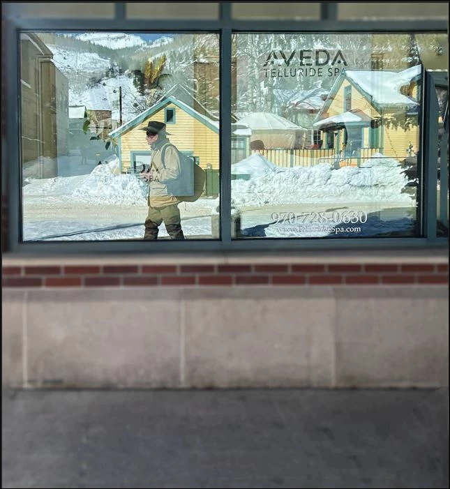

Select the part of the image you want to blur, create a mask from it (Add Layer Mask icon, bottom of Layers Panel), add Gaussian Blur to taste (I used a Field Blur in my ex. attached... but use whatever Blur you like - Gaussian, Box, Surface, Field).
I also did a variant where I selected the partial arm of the selfie-taker then did an Edit > Content Aware Fill on that selected area to get rid of it altogether and have a disembodied reflection.
I also reduced the exposure on the foreground a bit to draw more attn to the window glass and brightened the window up a bit and added some contrast. Again, so the attn goes to the sharper, brighter parts of the image. If you do the content aware fill and this last part of adjusting vibrance, contrast, exposure you may not even need much or any blur...
Have fun!

Thanks for the reply. What I want is to make the windows like a mirror. So that the image of the man and everything outside that's reflected in the window is all that you see. I don't want to show any of the insides of the business. Do you see how some of the things inside the business are interacting with the images of the things outside, and fading parts of the outside images?
