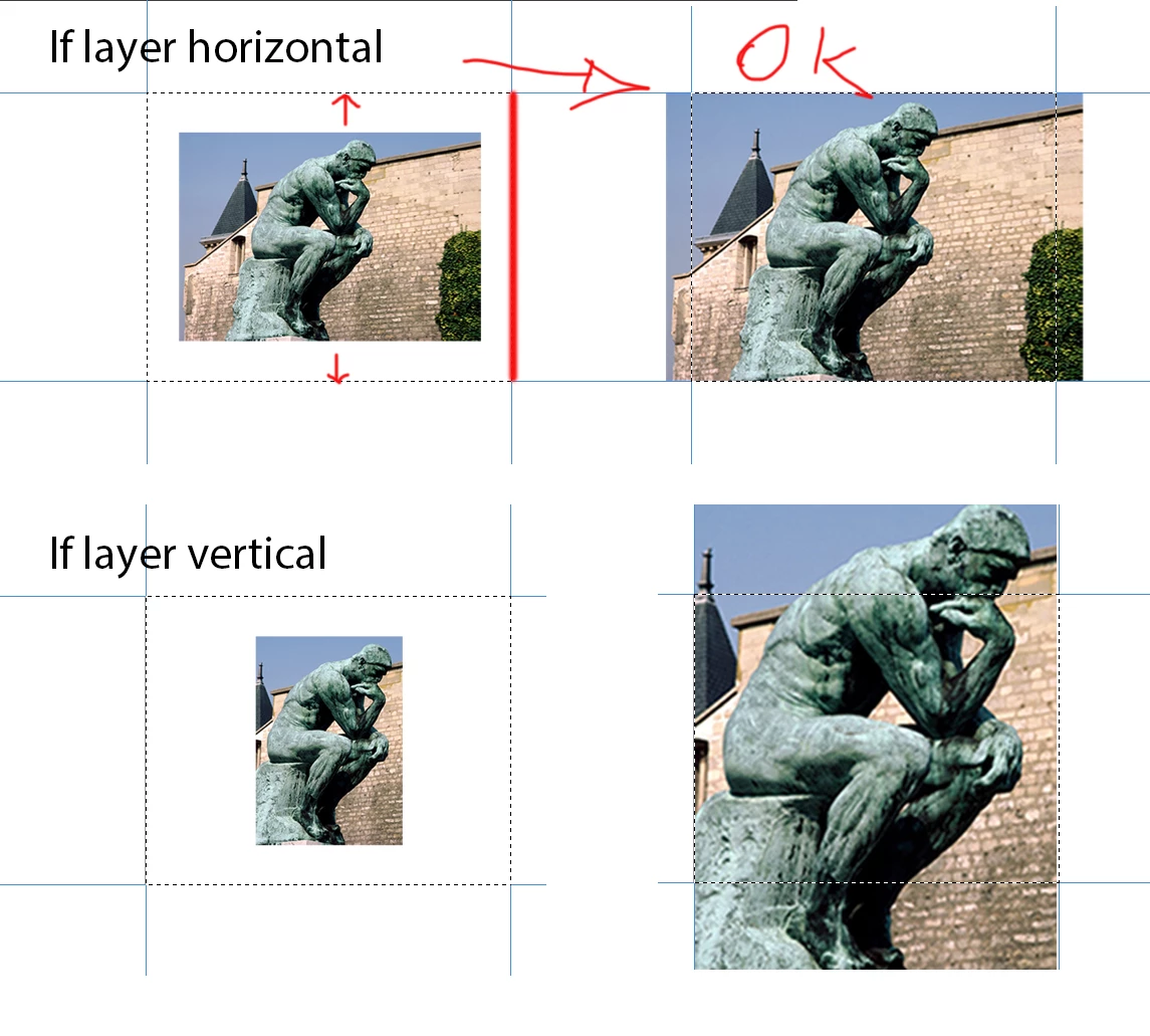

Hello!
I am trying to modify a script so that it can resize proportionally regardless of the ratio based on the minimum width size or the height of the active layer based on the limit of a selection.
I hear this but I get a mistake! Where am I going wrong?
    var docRef = activeDocument;
    var startRulerUnits = app.preferences.rulerUnits;
    app.preferences.rulerUnits = Units.PIXELS;
    docRef.activeLayer = activeDocument.activeLayer;
    app.activeDocument = docRef;
    var LB = activeDocument.selection.bounds;
    var res = activeDocument.resolution;
    var width = LB[2]-LB[0];
    var height = LB[3]-LB[1];
    var dwidth =   activeDocument.activeLayer.value;
    var dheight =  activeDocument.activeLayer.value;
    var ratio = height/width;
    var dratio = dheight/dwidth;
    if (dratio > ratio) {  height = undefined; } else { width = undefined; }
    //activeDocument.resizeImage(width, height, res, ResampleMethod.BICUBICSHARPER);////
     activeDocument.activeLayer.resize(width, height, res, AnchorPosition.MIDDLECENTER)
Correct answer JJMack
This may do what you want to do. Do not modify it to suspend history states for if you do it will be bitten by an Adobe Scripting Bug.
var res = activeDocument.resolution.value;
if (app.activeDocument.activeLayer.kind == LayerKind.NORMAL  || app.activeDocument.activeLayer.kind == LayerKind.SMARTOBJECT && hasLayerMask()) { deleteLayerMask ();}
var IB = activeDocument.activeLayer.bounds;
var dwidth = IB[2]-IB[0];
var dheight = IB[3]-IB[1];
if (dratio>ratio) {                           // layer's Aspect Ratio less the Canvas area Aspect Ratio
   var percentageChange = ((width/dwidth)*100);  // Resize to canvas area width
   app.activeDocument.activeLayer.resize(percentageChange,percentageChange,AnchorPosition.MIDDLECENTER);
else {
   var percentageChange = ((height/dheight)*100); // resize to canvas area height
align('AdCH'); // align to horizontal centers
align('AdCV'); // align to vertical centers
addLayermask(); // add layer mask to mask off excess

JJMack
JJMackCommunity ExpertCorrect answer
February 27, 2019

mauricior6328708
February 27, 2019
Perfect! Thank you for your dedication and willingness to help me JJMack.

JJMack
February 26, 2019
They want to fit an image to a selection. Not scale a layers by some percentage.
JJMack
JJMack
February 26, 2019
If you set guides like you seem to show you could do something like fit image to guide.  Be carefull if you suspend history. If you resize the layer when you have an active selection.  You also show an avtive se;ection. There is a bug in Photoshop scripting that will bite you. I reported it years ago when I wrote my  fit image to guide scrtpt. Photoshop: Script bug resize layer back document up one history state | Photoshop Family Customer Community
Perhaps the code you posted you though you were getting the select area sides.  You can get a selection bounds like you can get the layer bounds like you did.  With the selections bounds you can get the x,y location and with and height of the selected area to use in your math logic. For best fit you  need to compare the two aspect ratio the Layers aspect ratio and the selections area aspect ratio to figure out if you should reside to the selection width or height. It not a landscape or portrait thing for the are two aspect ratios involved.
This will work:

It would be something similar to your script ... we would only switch guides for selection .. I have been looking to clean up my scripts as much as possible.
I believe that in the script I posted this is possible, if you change the last line:
that:
per:
you will notice that the size of the document change with reference to the limits of the selection.
Why does not this work with the layer?

mauricior6328708
February 26, 2019
JJMack  escreveu
Why
Why not just
var dratio = 1;
This ensures that the selection is completely filled, the pixels that exceed the selection will be eliminated by a mask.
