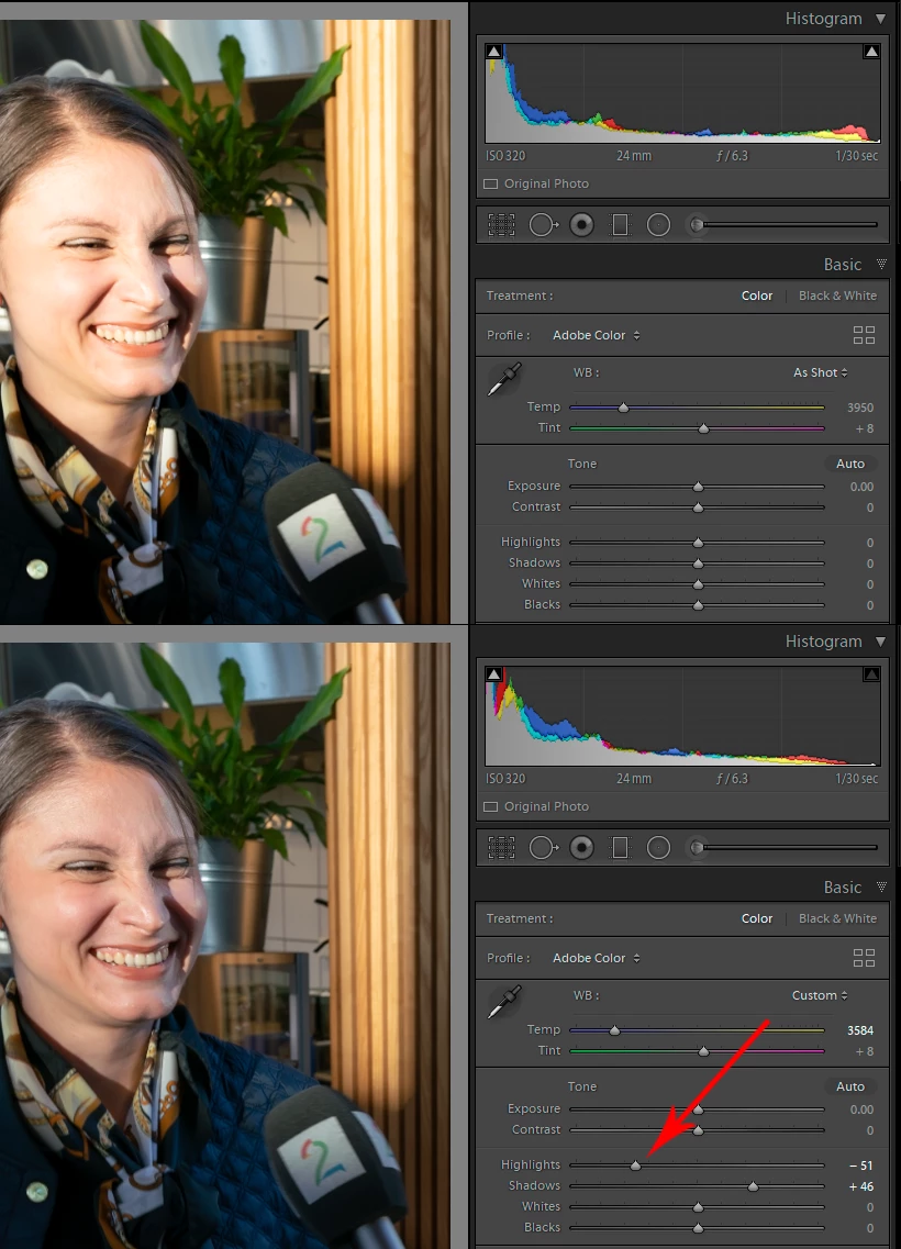

If by "hot" you mean actually burned out and clipped to white, you can't do anything in the RGB file except rebuild it. The information is gone.
But the raw file, if you can go back to that, may still contain the information. This screenshot is from Lightroom, but ACR works the same way:

Take a look at the raw conversion first, there is more latitude for highlight adjustment than in the rendered file. You can then look at the Image > Adjustments > Shadows/Highlights command in Photoshop and selective masking, also perhaps optionally using blend modes such as darken.
