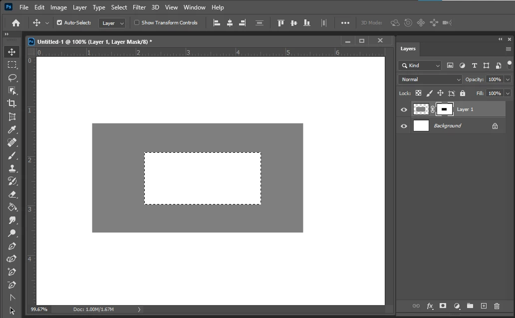

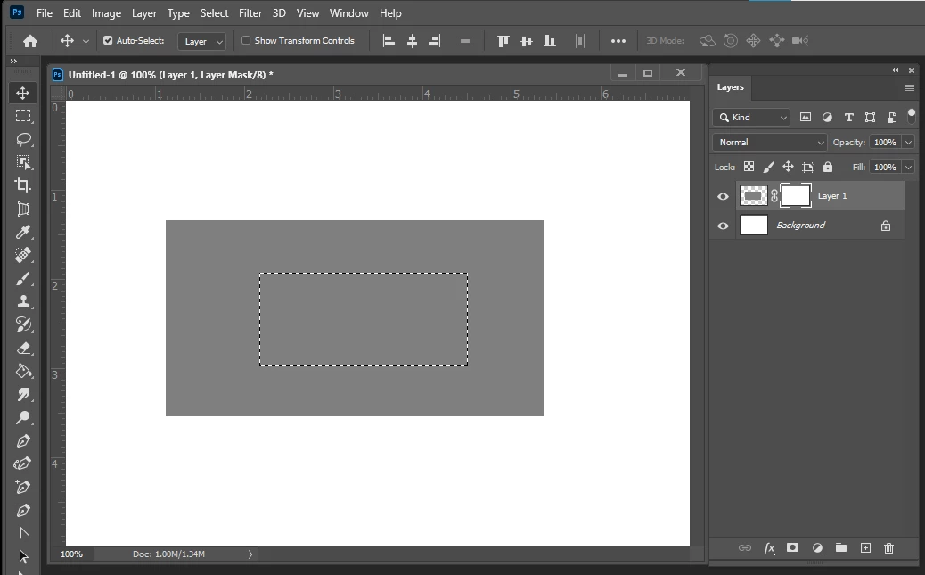

Shapes have vector mask you would be to use a vector tool to change  the shape of a shape layers.  Painting on a gray scale Layer Mask just hides or reveals  the layer's  pixels there are  no vector it not a shape layer.  Shape layer are fill layers that have vector layer mask. The fill can be a solid color, a gradient or pattern.
If you make a selection and have the move tool active and have checked show transform controls you will see the bounding box.
fill black
