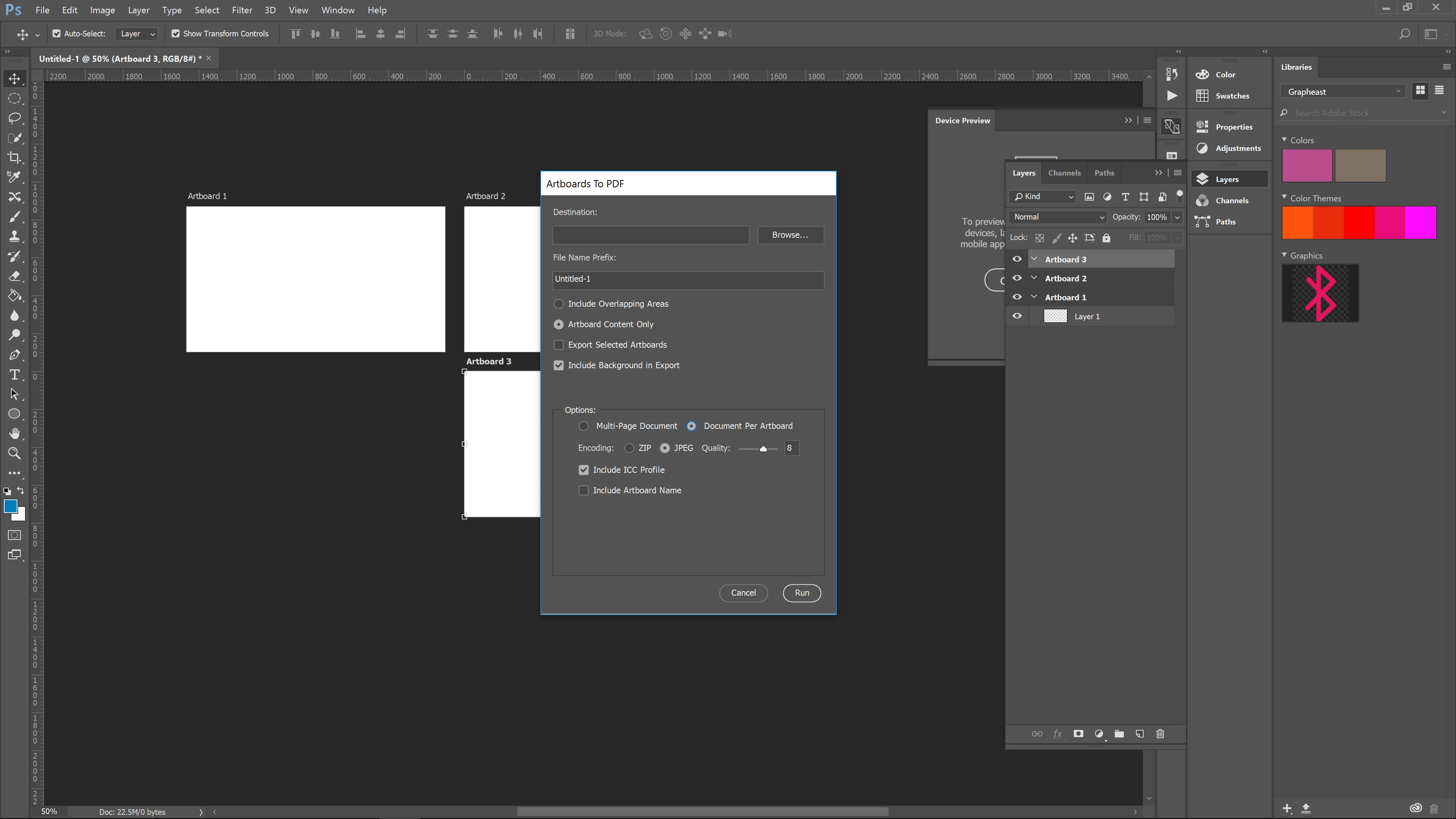

hey
after you you make your artboards go to file>export >artbord to pdf then do as same as the photo
February 27, 2017
Thanks so much for you reply and screenshot. Actually, I've got that part. What I'm looking for is a way to export the artboards as flattened PDFs in a smaller file size. I opened one of the PDFs exported in this manner and it was an editable layered file that was very large.

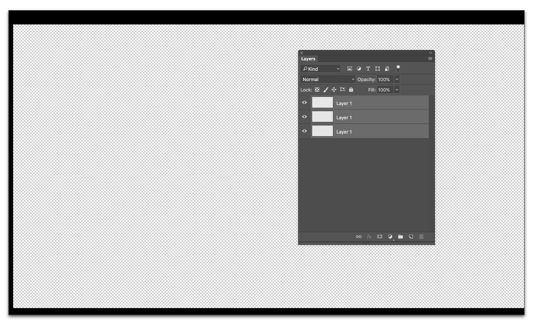

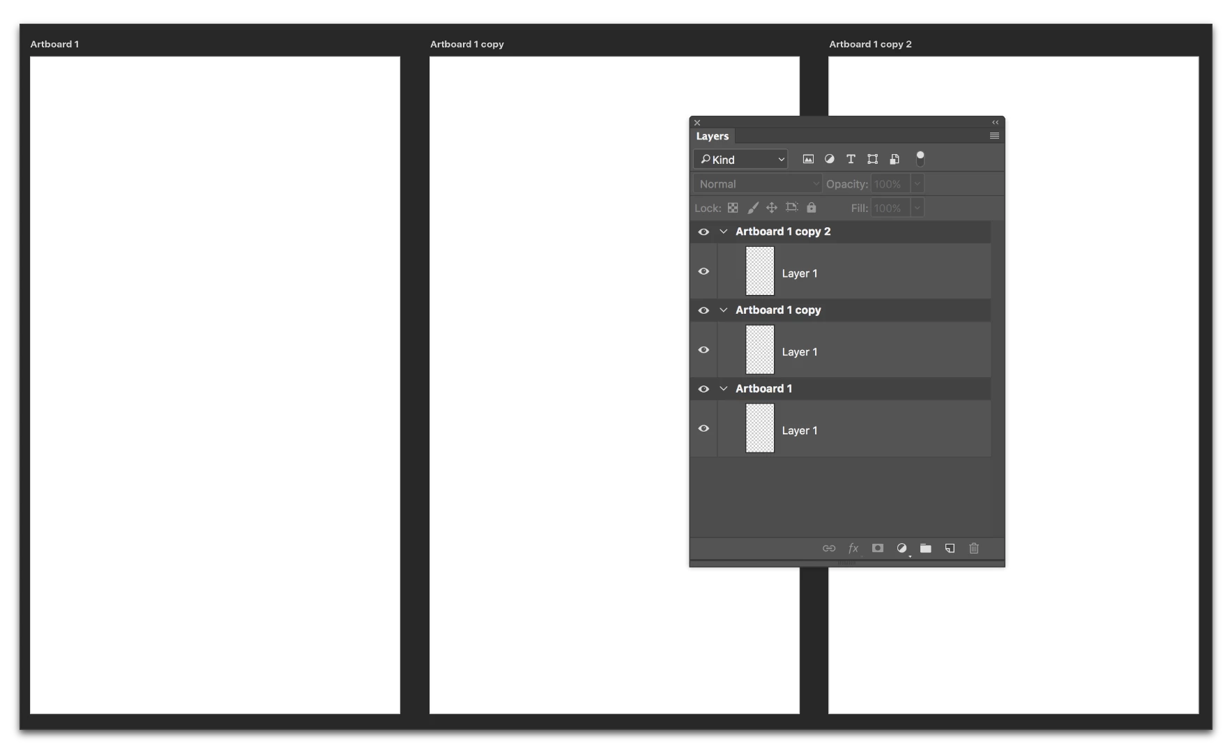

I learned on this forum is that artboards aren't what we think they are! They are actually windows into a background. Think one large background, divided into 3 smaller views (if you have 3 artboards).
For example, 3 artboards:
Then select and ungroup them to see that it is one wide document large document.
I suspect that this is having an impact on the file size. You could save a copy and play with this theory (keep the original safe): Delete two of the artboards, ungroup the remaining artboard, crop to size and then make the PDF. What happens to the file size after that?
