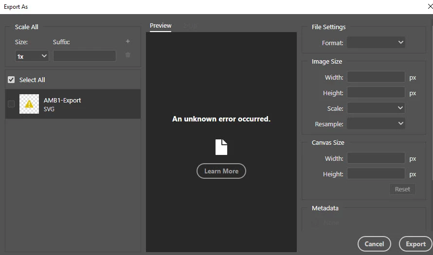

I'm using PS to create a floor map with offices and cubes.  I create layers for each cube/office location on the map.  I then do an Export As SVG to create the SVG file.  However, I have come across a problem if there are too many layers.  The layers only consist of 2 pixels in opposing corners to outline the cube defintions.  The layers are all identical sizes so the SVG contains mostly G & USE elements.  So its not a complexity issue.  It seems to be an of layers issue.  I can do an Export As to a PNG/GIF/JPG with all the layers.  But the same PSD to SVG comes back with the error: "An unknown error occurred."   I have tried this on a Windows 10 and Mac OS, all with the latest versions, with the same results.
I'm aware that PS may not be the best tool, but that is what I'm using as it produces the best SVG code(when it works) that I can parse on my website.
Any help would be appreciated.
JJMack
August 28, 2020
Are you Aware that Photoshop does not support Vector files.  If you export svg files form Photoshop. Photoshop may be able to create vector files for Shape and Text layers they are vector layers in Photoshop.  However, Photoshop is a Pixels editor so most of the content of that a svg file Photoshop creates will be raster image information.  If you use Photoshop menu File>Open and select  a .svg files you will see Photoshop switch to import files where you can import the vector file as a single raster layer. in a new Photoshop document.
JJMack
TODD5E23Author
August 28, 2020
Thanks for the reply.  I'm aware of the Photoshop limitations.  Maybe there is a better solution.  I just came across an old post of yours referring to a script that outputs the layer bounds info.  That is what I really need.  I have an image in PS that is a floormap.  I'm creating a layer for each office/cube.  If I can get that info in a text file where it can output the group name, layer name, x, y, w, h cooridinates, that would be ideal.

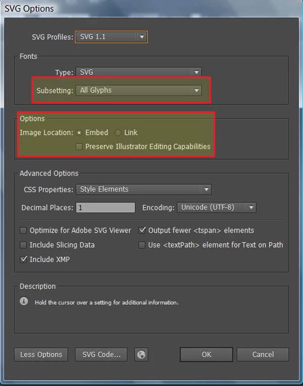

Converting raster images to SVG rarely produces a usable product.  IMO, Photoshop is the wrong tool for this. You should use Illustrator to create your vector graphics and then export to SVG.
TODD5E23Author
August 28, 2020
Thanks Nancy.  I tried Illustrator but it does not produce the same type of output that the PS does.  At least that I could figure out.  A sample is below.  Also, it does not solve the original problem/question.  If it is a limitation of PS that it can't handle more than X # of layers, then fine.  But to get an Unknown Error message means there is a bug in PS that should be reported.  If there is a way in Illustrator to create the same type of output as below, please point me to where I can get more info.  If I should be creating the layers in PS differently to avoid the error, that would be helpful to know as well.
Thanks
