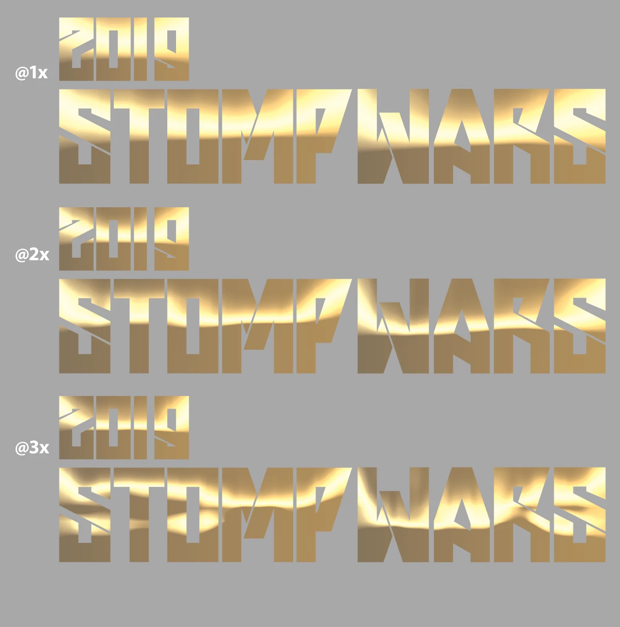

    January 24, 2020
    I ran into the same issues. Here are the results I was getting. You can see how the gradient shape distorts then changes completely.
    The only way I was able to correct it was to Rasterize Layer Styles and then Export As…

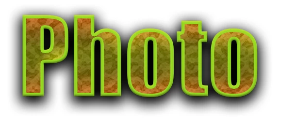

    You might need to restart! I just Exported it and all the effects are there! (of course a flattened file but I see my effects..)
    Enclose is a sample.... I added all the effects to make sure they all stay and they did!

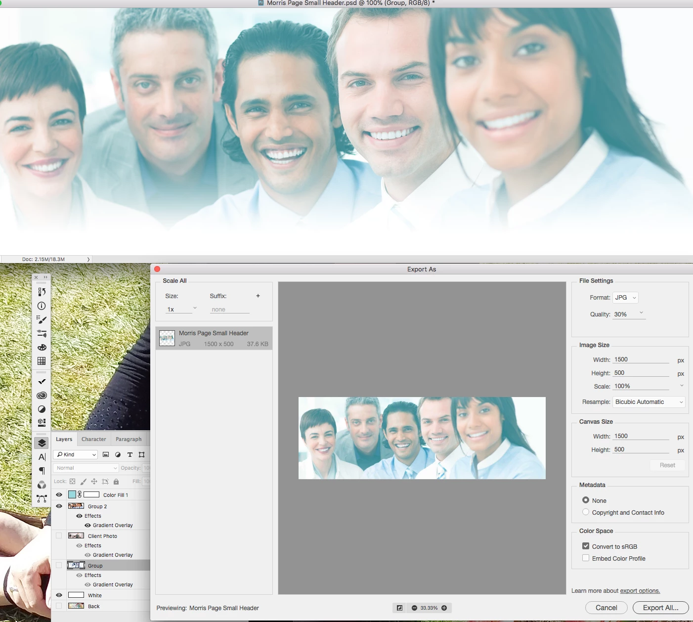

    December 29, 2017
    See attached screenshots. Shut down PS, restarted and this. Not sure what I'm missing. Original art up top; export options below; layers palette to the left. Missing bottom white grad.
    chanaart
    December 29, 2017
    You have a layer mask that creating the effect. Use PNG and make sure it is transparent Background!
    PNG will maintain transparencies. Also you have Quality 30% so it might take out some effects. Try Quality 100%
