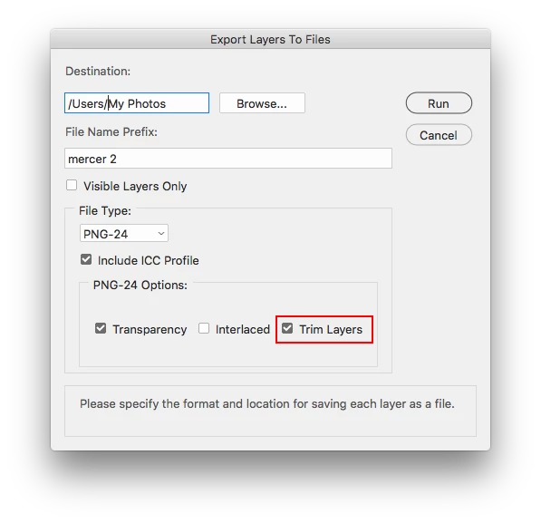

September 17, 2020
Yes if you use PNG-24 as suggested by GI87, then there is a Trim Layers option.

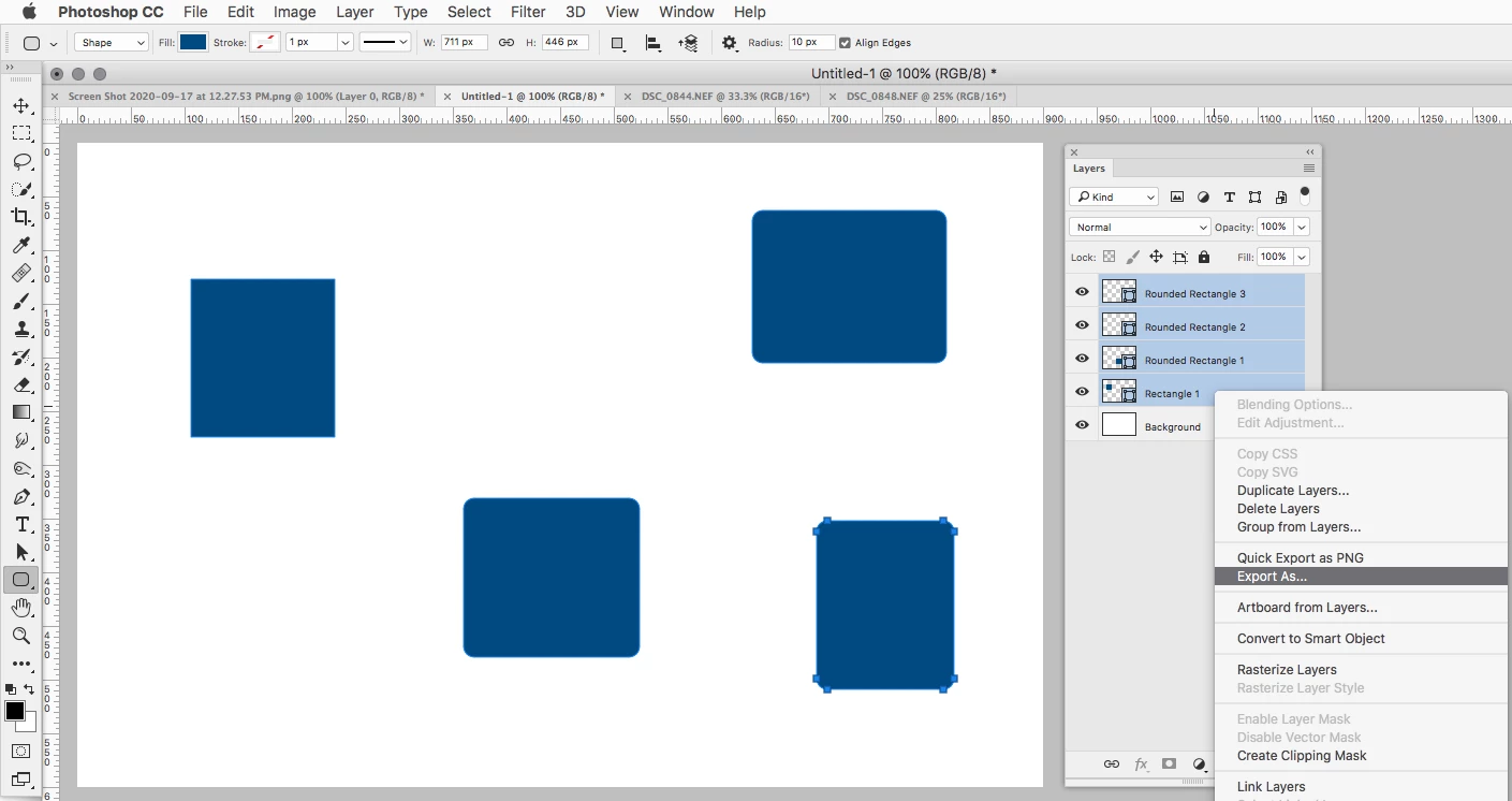

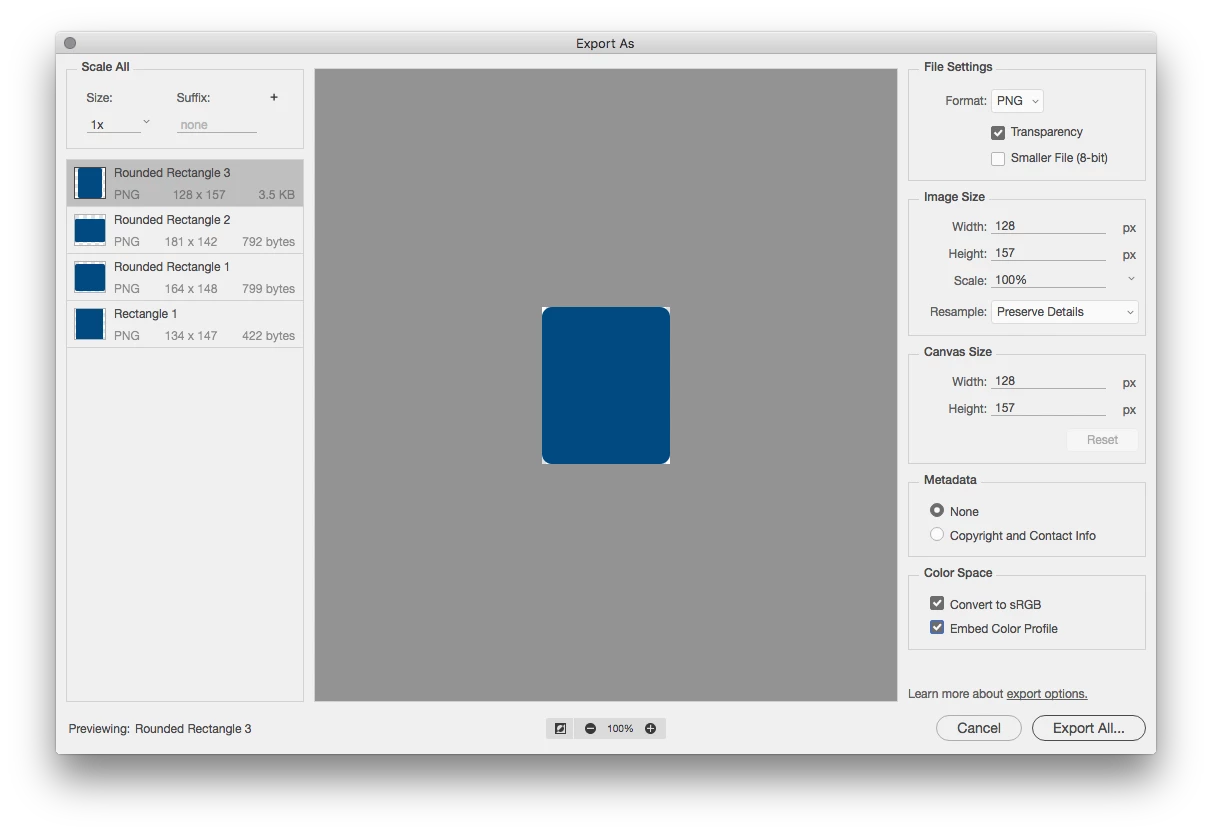

Another option is to select the layers in the layers panel. right click and Export As, which should Trim the layers.
