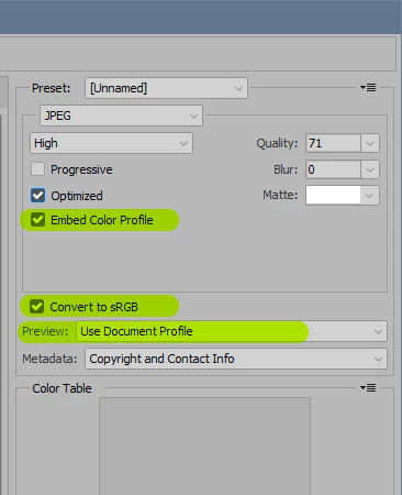

Safe For Web needs a little care in setting up, because it has all color management turned off and disabled by default. These are the settings to watch:
The "preview" setting is the one that most often trips people up. This is where you enable display color management, so that the SFW dialog displays correctly.
"Embed profile" should always be checked, no exception, and "convert to sRGB" should normally be checked for web use.
And yes, as digitaldog says, "Proof to Monitor RGB" turns off all display color management in Photoshop.
