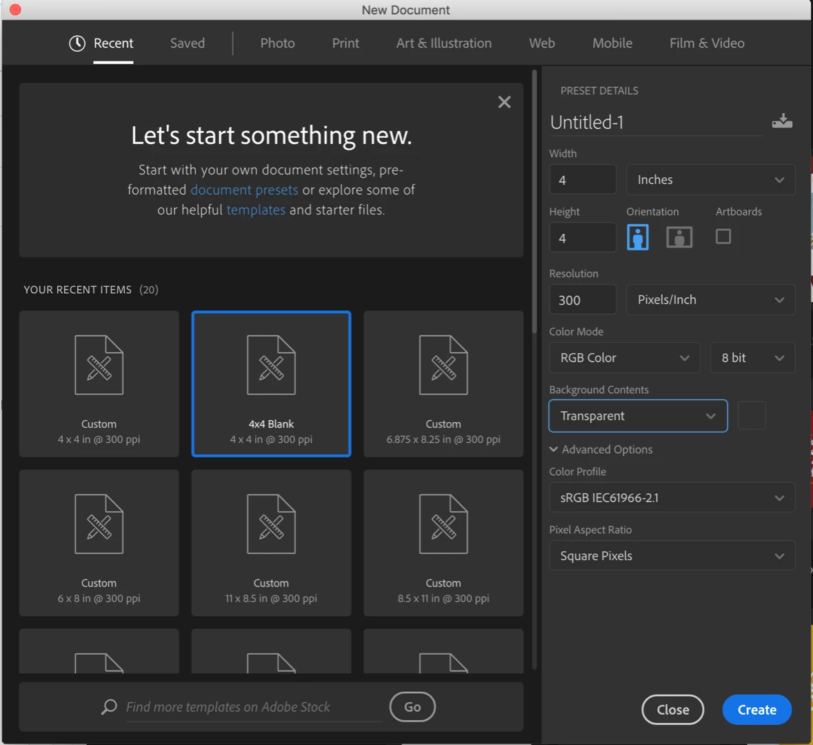

I start the process by creating a new document with a resolution of 300 pixels/inch and sRBG Color Profile.

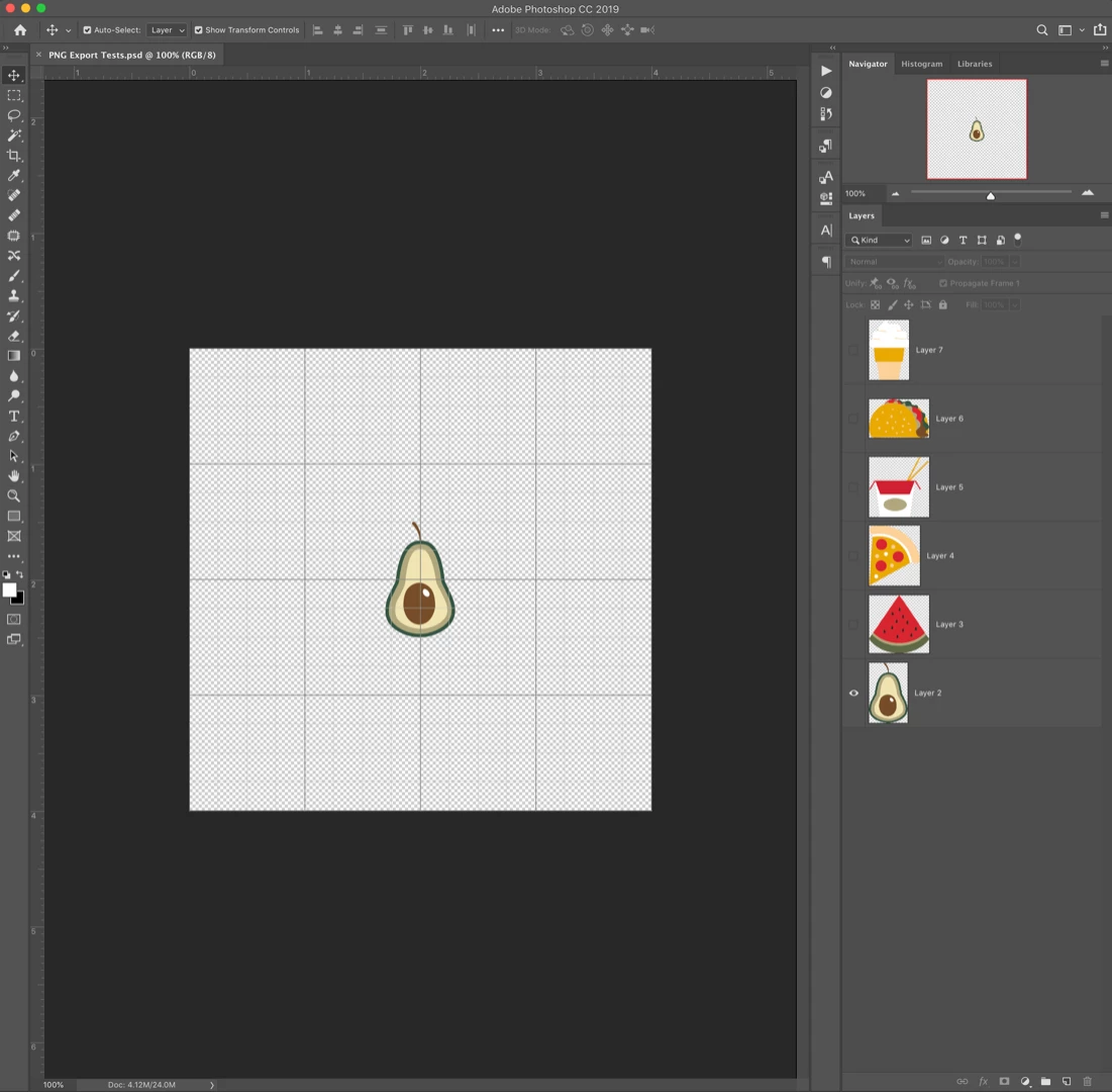

I then copy the graphic images from Illustrator into individual layers in my Photoshop document.

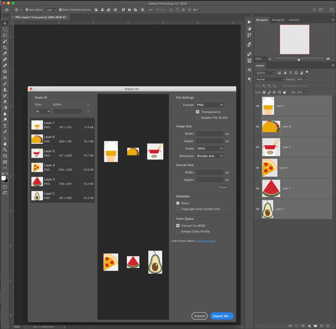

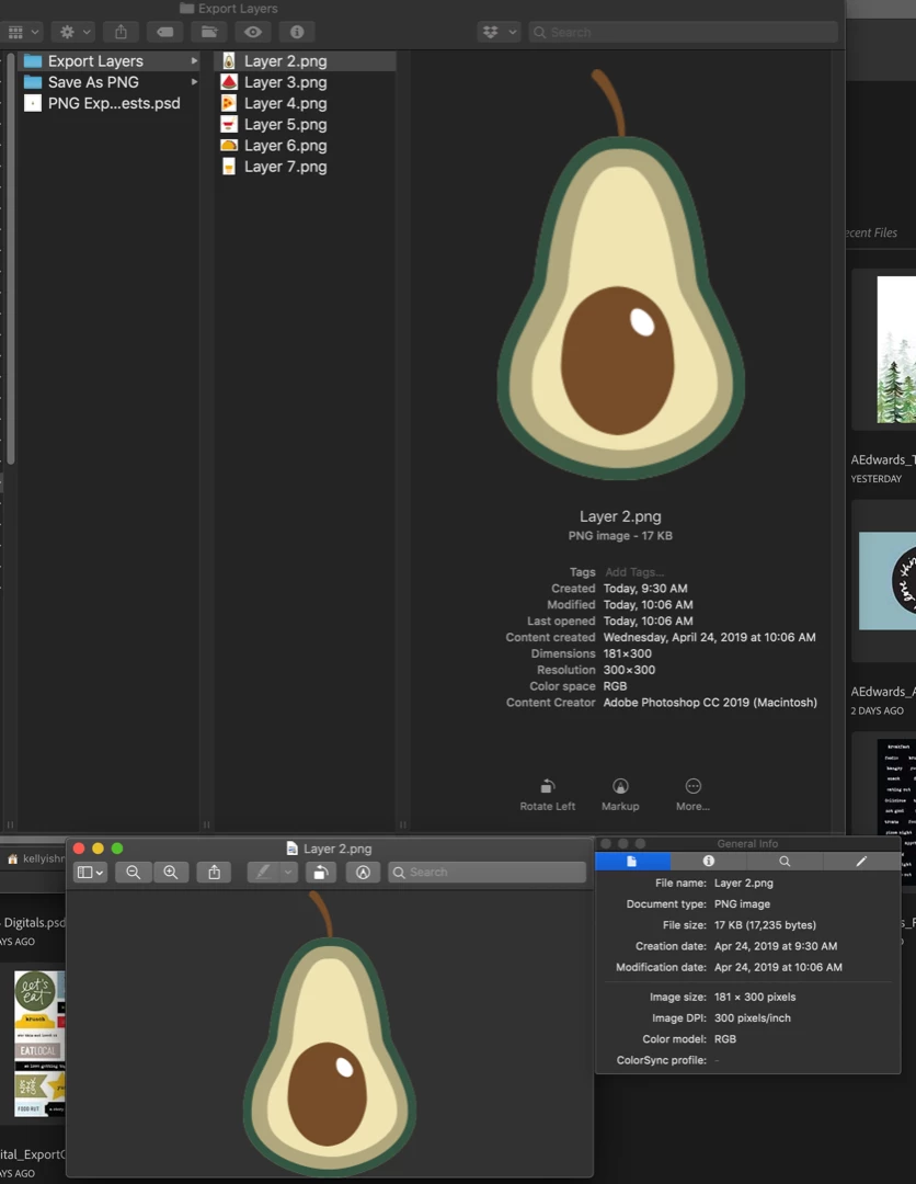

I have been using the 'Export As...' option in the layers panel as a shortcut because there are often hundreds of images to export in one kit. I select the PNG format, the 'Transparency' checkbox, and 'Convert to sRBG' checkbox.

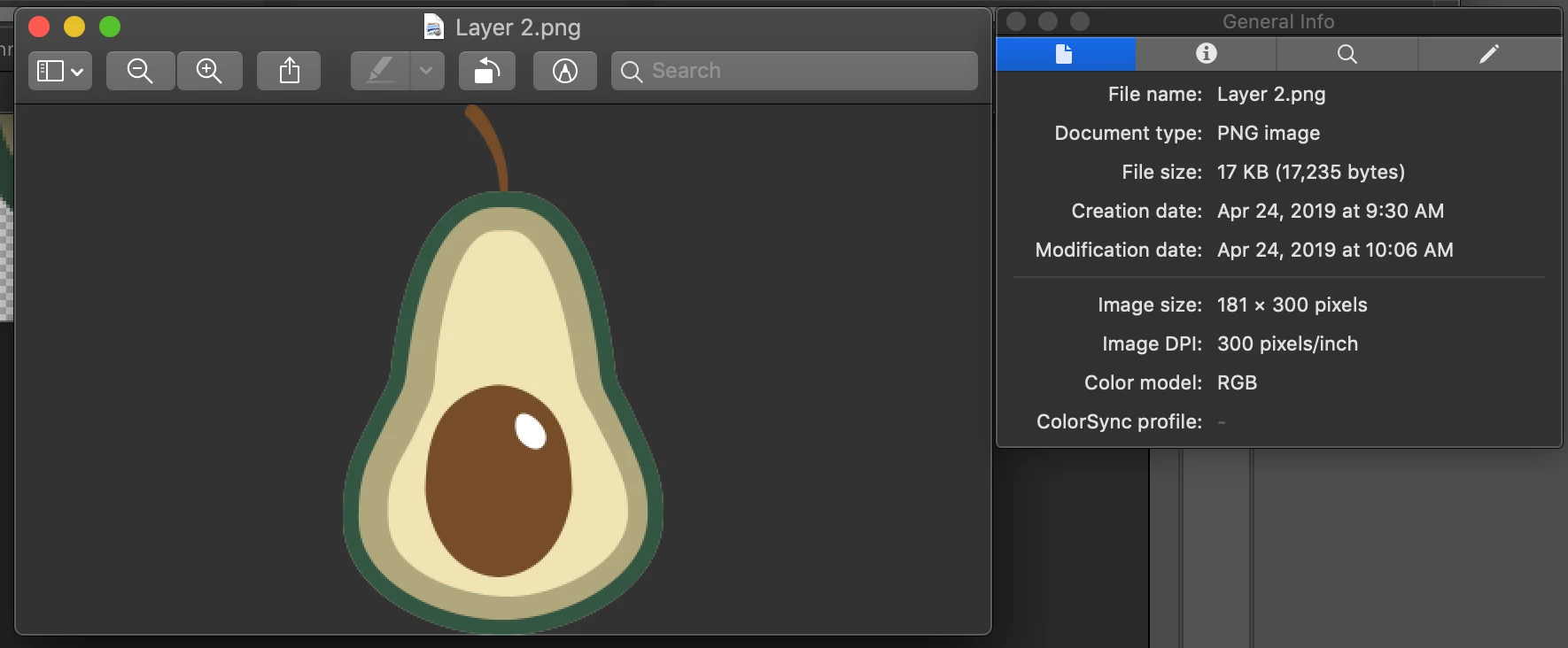

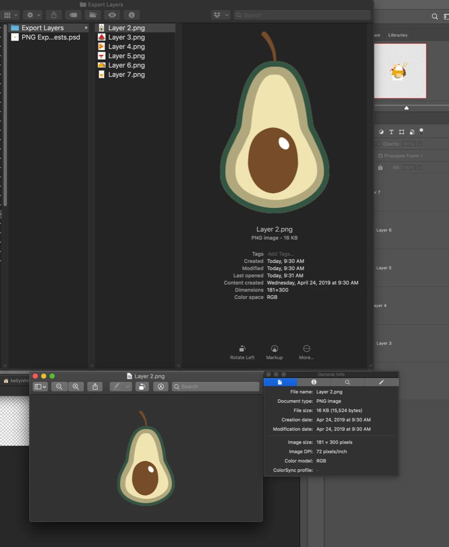

Upon viewing the image in Preview, the exported images did not appear to retain the sRGB Color Profile (according to the ColorSync profile) and the resolution is only 72 pixels/inch.

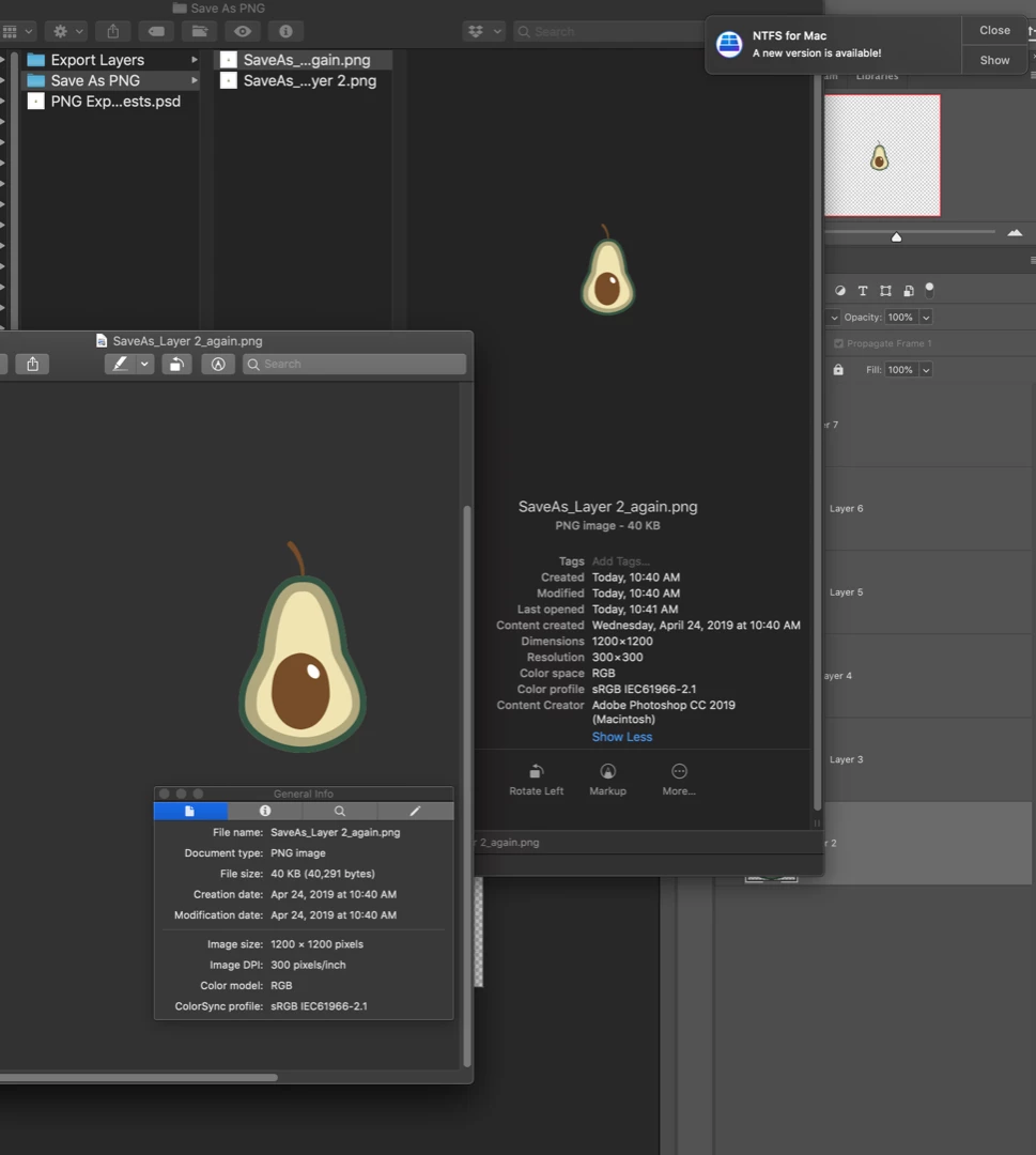

If I use the 'Save As...' option, it appears to retain both the 300 pixels/inch resolution and the sRBG color profile.

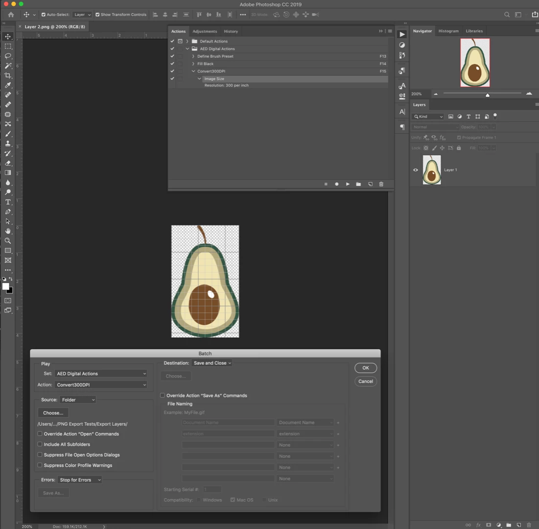

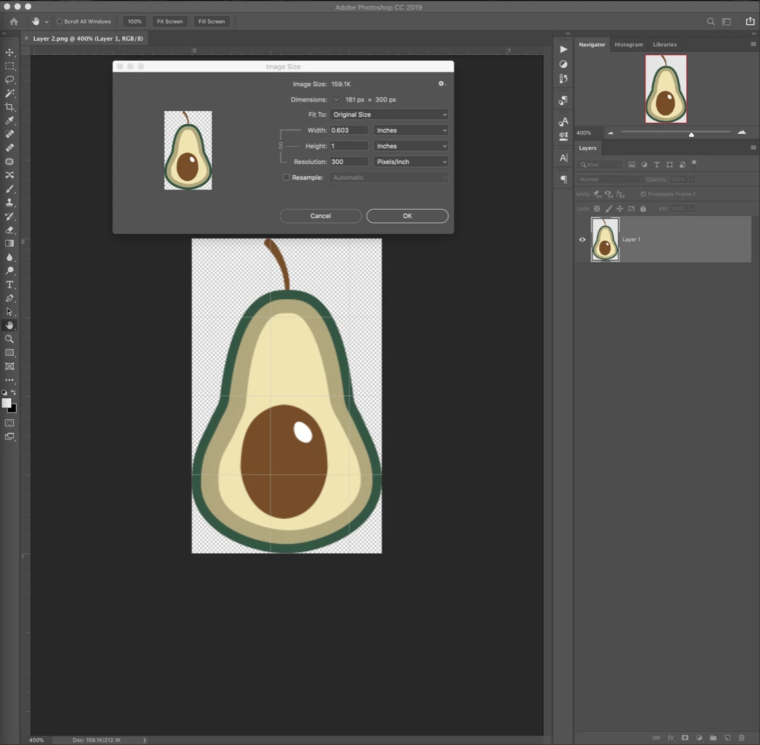

I researched the problem with the resolution at length and discovered that the exported resolution of 72 pixels/inch is a known issue with the PNG layer export. In one of the other forums, I found a workaround for the resolution issue using the Batch processing tool to increase the resolution to 300 pixels/inch.
This batch action updated the resolution for all of the images in the folder as described in the workaround.
When I open the batch-processed image in Photoshop it confirms the resolution at 300 pixels/inch.

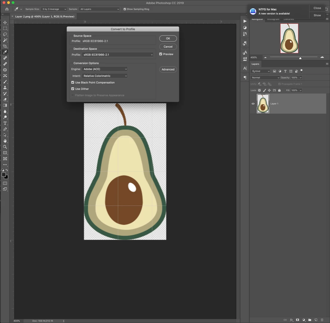

Regarding the Color Space issue, in Preview, based on the ColorSync profile, it appears that my images did not retain the sRGB profile.
But, when I check the colorspace by selecting Edit>Convert to Profile... I see that the Profile in the Source Space is sRGB.
Does this mean that the sRGB color profile has been retained? Even if the ColorSync profile in the image preview information is blank?

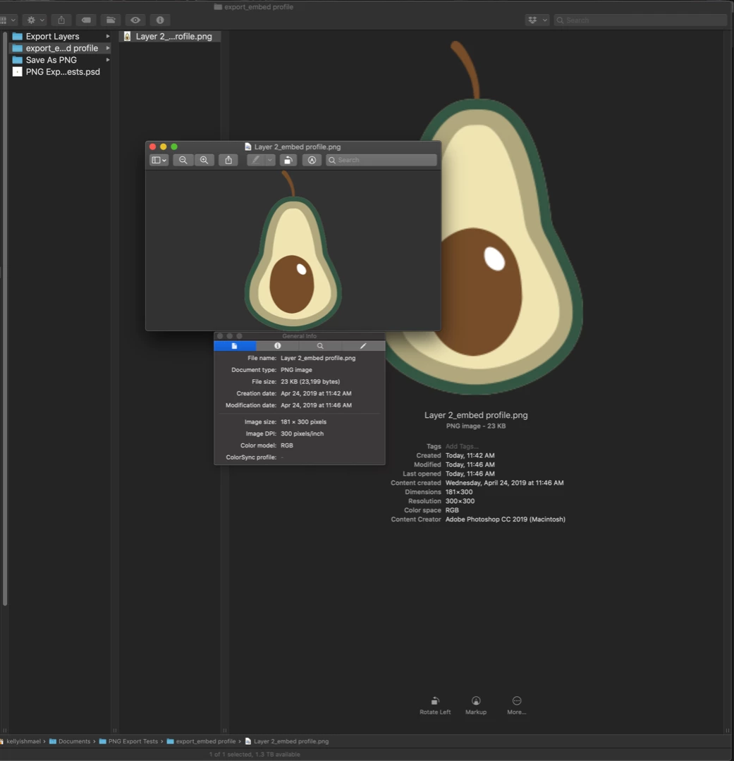

    Export strips the profile at default settings. Check "Embed Profile".
    The resolution is also stripped, because Export is intended for screen, web and mobile devices, where ppi doesn't apply - it's not relevant and not needed. The exported file doesn't have a ppi, not 72, not 300, nothing. The 72 figure appears as a default when the file is reopened into another application. It may be 72, or 96, or any other arbitrary figure.
    If this is not for screen, web and/or mobile devices, use Save As.
    kellyishAuthor
    April 24, 2019
    Thank you so much for the information.
    When I export with 'Embed Profile' the Color profile is retained.
    The problem occurs when I run the Batch process to change the resolution because it strips the previously embedded Color profile from the image information.

    To keep this in perspective, that avocado illustration is only 181 x 300 px – which is 1.53 x 2.54 cm @ 300 ppi… Not a very large image as raster images go, it would obviously be best as a vector graphic.
