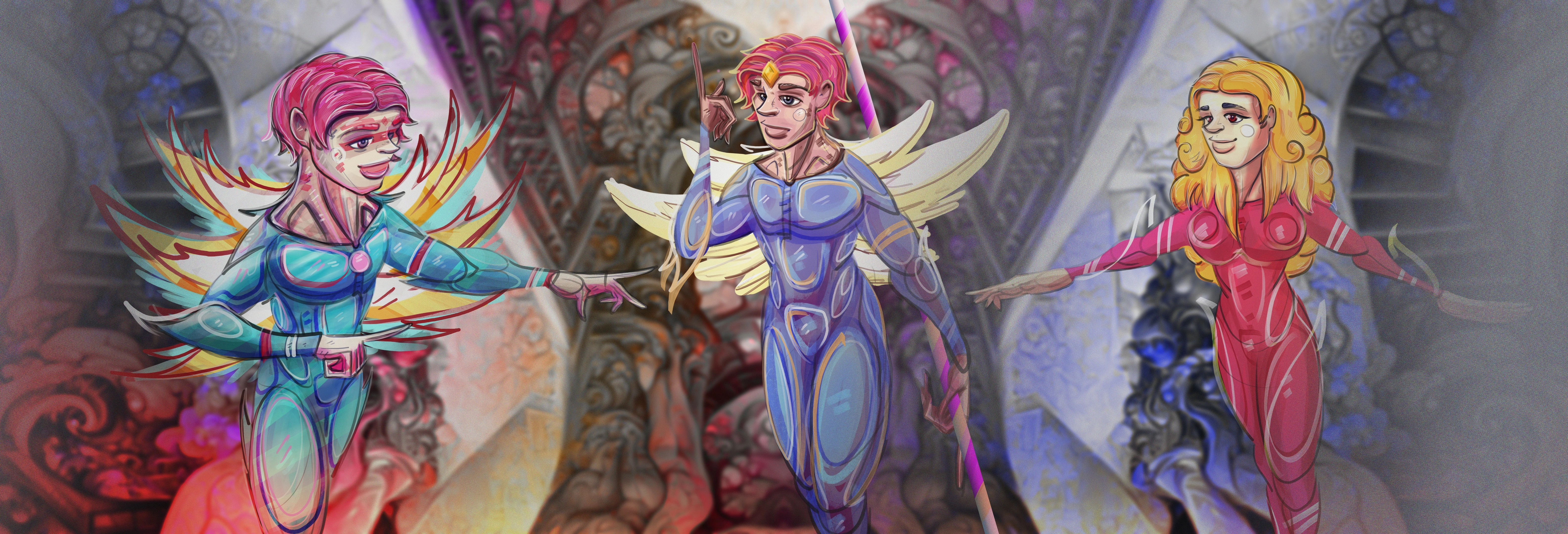

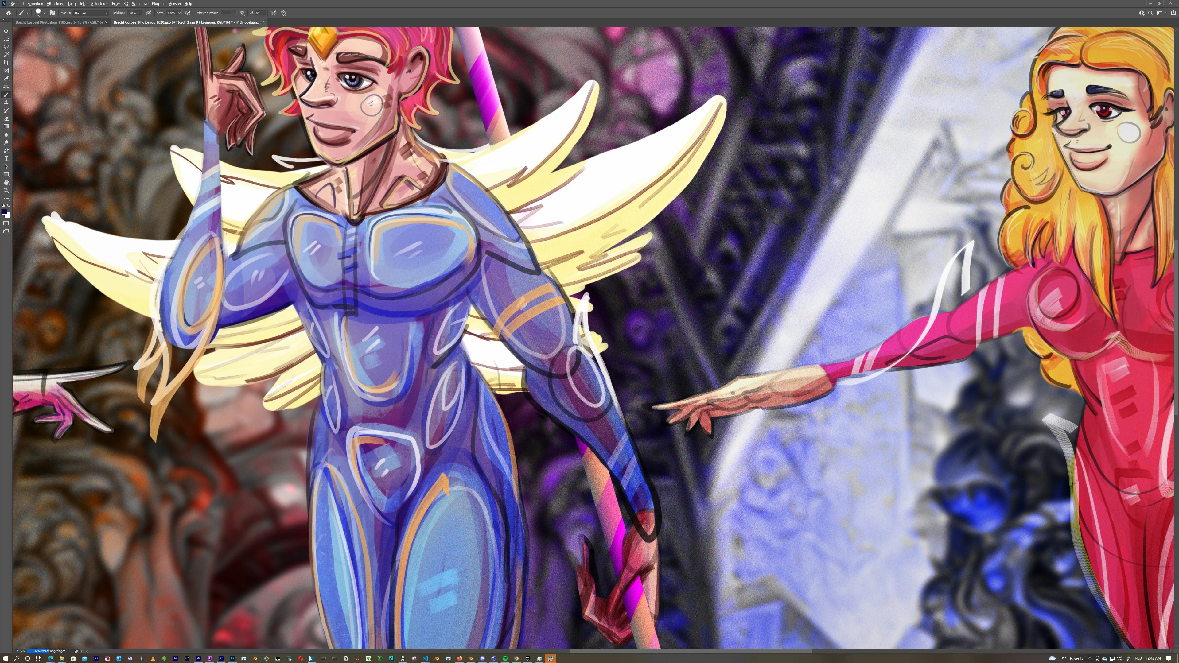

Flattening does not work gives same problem, all other layers have blending modes on, is only a problem with noise, has been an issue for many years, only now did I find it important enough to complain as this prevents me from adding texture and detail to my file.
file res:  30.000 x 10.000
pretty sure this is one of those super high res problems.
Screenshot in photoshop:
 export:

Hi
The reason is the way that the preview is calculated in order to produce an image at speed.
Photoshop can handle 300,000 x 300,000 pixels and use hundreds of layers. In order  to quickly display a preview image when zoomed out, e.g. to see the entire image, Photoshop averages the pixels on each layer into groups and then blends those groups together for each layer. There are cache levels used for calculating and storing these groups (set in Preferences Performance).  If it did not work that way, Photoshop would have to calculate the individual blending for every image pixel then it would average the results together for display as no screen has that many pixels. That additional processing would result in an extremely slow screen response.
At a zoom level of 100%, which means 1 image pixel mapped to 1 screen pixel, then blending of every individual pixel is done (no combining of pixels in each layer first) and the result displayed on screen. However this is only needed immediately for those image pixels covered by the screen area so speed of screen redrawing speed is not an issue.
When flattening or exporting an image , every individual pixel is calculated before blending. So this matches the method used at 100% zoom.
There is also another impact if you work in 16 bits/channel. At zoom levels of less than 66.7%, the preview is calculated using 8 bits/channel. Again this is done for speed.
In 99% of images the difference between the two screen preview methods is so small it is all but invisible. However if the image has fine noise then that difference between blend every pixel and average groups then blend those groups can indeed become visible. That is why blending should always be checked at a preview of 100% zoom as that is the only entirely accurate preview.
Dave
