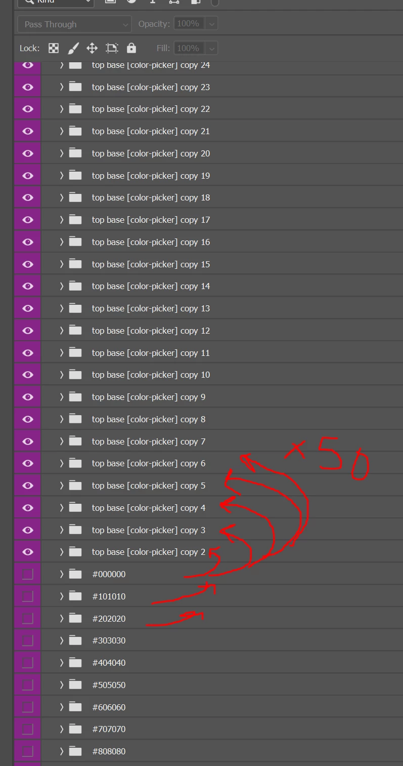

I have layers organized by shape, each in 50 colors.
But I need to re-arrange them by color instead.
So right now I'm dragging layers by hand.  There's 9 shapes and 50 colors, so that's 450 layers.
And then I'll have to repeat this whole process another 10-20 or so times.
I would record a script but I'm not even sure how I would go about that.
Flash has some cool "distribute to layers" type functions that come to mind but I don't think there's anything like that in Photoshop.
Does anyone know if there's a faster way to do this kind of re-arranging?
eg. the #000000 folder has 50 layers inside.  Each one needs to go into a different folder above, ditto for the other folders below.

I'll try to put it a different way.
Right now the folders are arranged like:
Folder 1 - layers A, B, C, D, E, F
Folder 2 - layers A, B, C, D, E, F
Folder 3 - layers A, B, C, D, E, F
And I want to re-arrange them like this:
Folder 1 - A, A, A
Folder 2 - B, B, B
Folder 3 - C, C, C
Folder 4 - D, D, D, etc.
To make a script, as far as I understand, all folders and layers would need to be visible and open.  So then I'd be manually moving one layer across hundreds of other layers, hundreds of times.  Theoretically possible but... mind-bogglingly cumbersome.  Is it possible to insert a layer into a folder that's not open?  That could help make it more feasible but I don't think there's a way to do this in a way that can be captured by a script...
