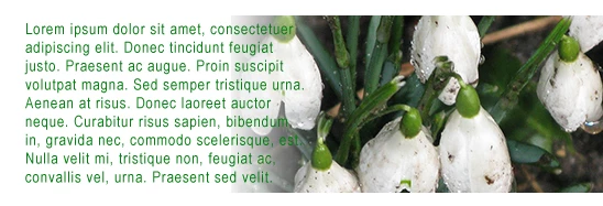

    August 5, 2010
    Before I explain, is this what you want?
