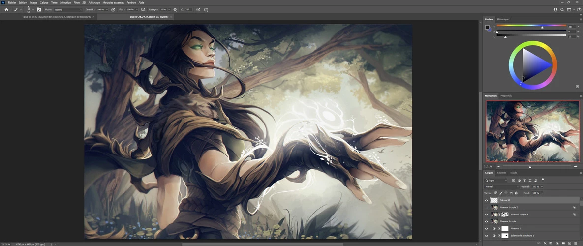

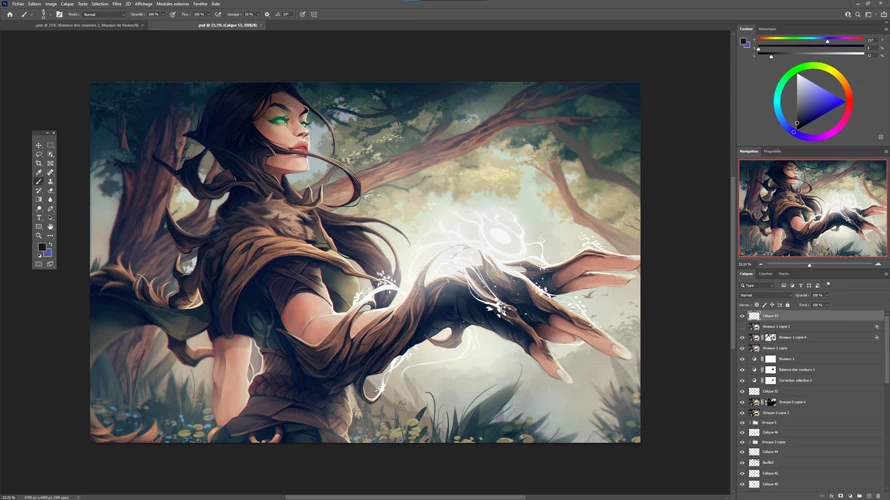

The correct colors are on image 1 and the screen where they are not are on image 2.
On this one, the image and the color wheel change, but note that the navigation window keeps the correct colors.

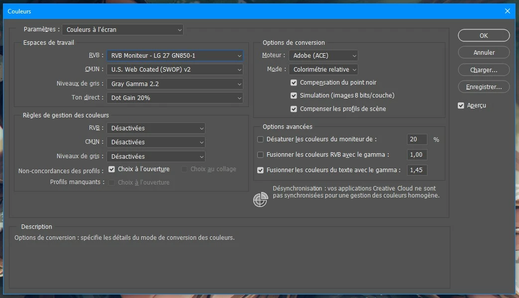

I also attach a screenshot of my color settings (image 3) if it's help.

You have turned color management off. No wonder the colors are all over the map.
Reset your color settings to default. Never set your monitor profile as working RGB. Always keep color management policies set to "preserve embedded profiles". The document profile (and working RGB) should always be a standard color space like sRGB, Adobe RGB or ProPhoto.
No exceptions. The settings you show in your screenshot just survive as legacy settings. They have no purpose today and a huge potential for permanent damage.
The monitor profile should be made with a calibrator, that's how Photoshop is designed to work. If you don't have one, use a standard profile or the manufacturer profile. The monitor profile is set up at system level and it has no place in color settings.
