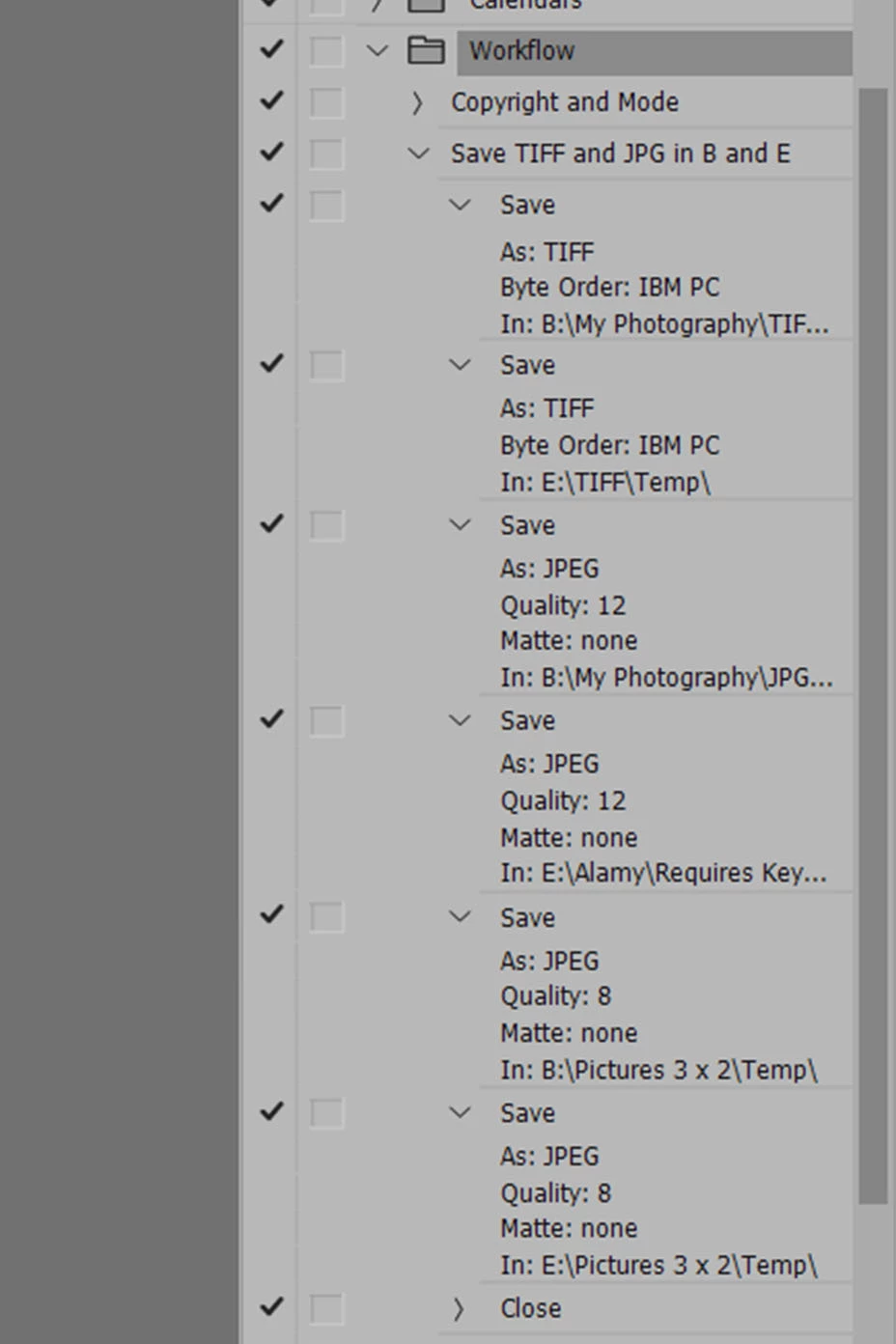

Since the latest 21.1 update I can no longer successfully run an Action for processing batches of photos and saving them into multiple locations. after the first successful Save As, the second one to a separate location stops the Action with the error message "Won't save file as filename is not valid".
I have tried reinstalling 21.1 without any change. Previous versions ran the Action with no problems. The file names are valid and a simple Save As on an individual basis works as it should. I have temporarily reinstalled 21.03 as a solution.
Any help would be appreciated.
Thanks, Rob

    If you didn't "downgrade", then the only options I am aware of are as follows...
    You can record Image Processor Pro into an action step. Even though it is designed to batch process, it can be used just to save a single image step in an action (it will record as a blank step, but it does/should work fine).
    https://sourceforge.net/projects/ps-scripts/files/Image%20Processor%20Pro/v3_2%20betas/
    Another option is to replace the save/save as step with a script, the community would just need to know the file format settings and save location in order to code the save.

    Thanks Stephen. I think I am more comfortable to stay with the downgrade 20.3 and patiently wait for a bug fix rather than delve into the different solutions you are suggesting here. I did have a play with using ascript but it wasn't as effective as the action I was used to.

    It seems there is a bug in latest 21.1 version regarding batch actions to save in different locations. Use previous update until they fix issue, I do not know for better solution at the moment.
