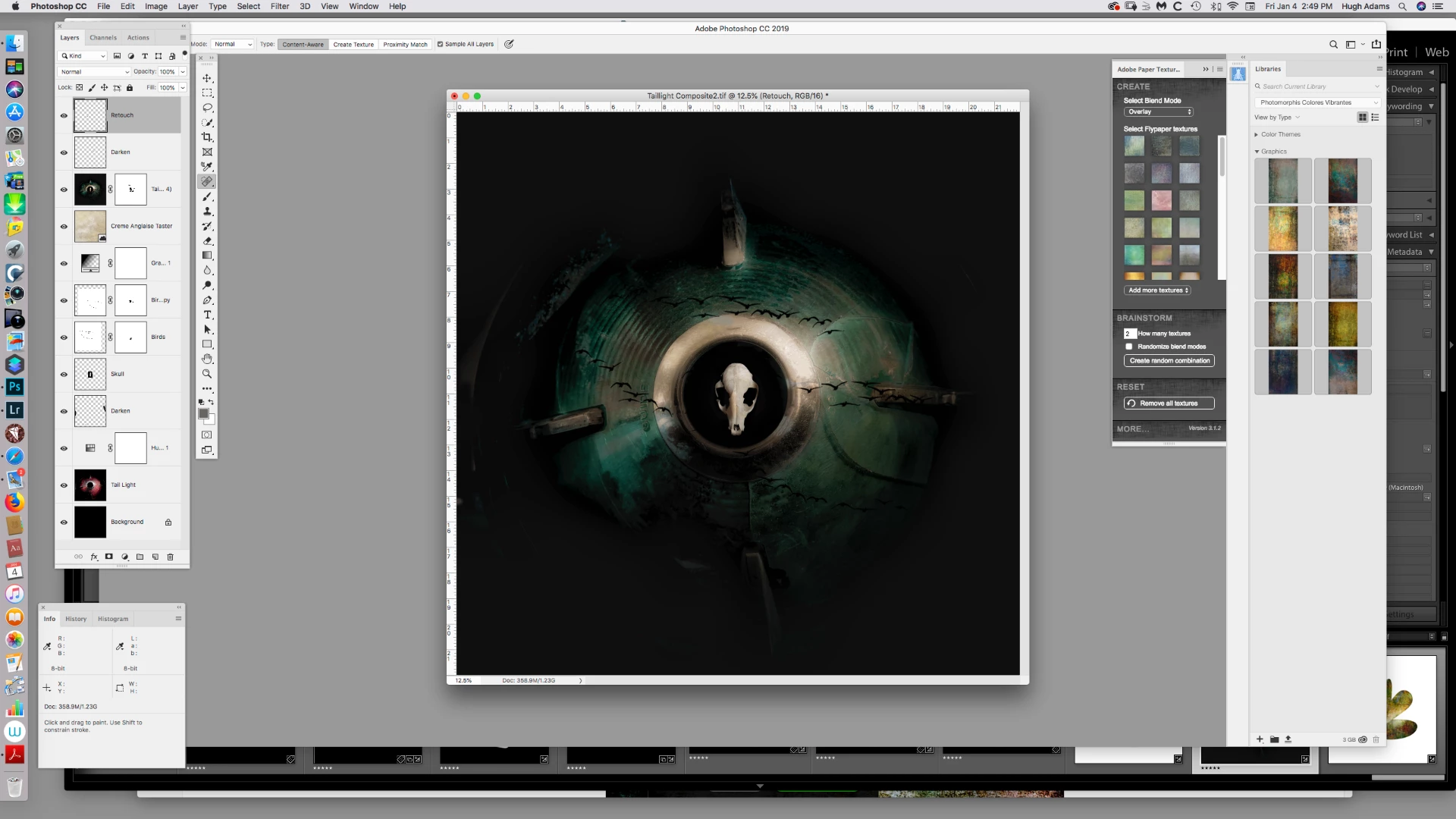

I am having issues with PS file sizes. I do compositing, however, I do not have that many layers yet the file size is over 4GB when the file size on the image says 1.2GB and the file will not save to Lightroom. An issue Adobe needs to fix.
I generally do not use Smart Objects and try to limit my merged layers to one.
Attached is a file that PS will not save as it is over 4GB yet I have no smart objects, one merged layer, and the other layers just adjustment layers.
Please offer any suggestions.

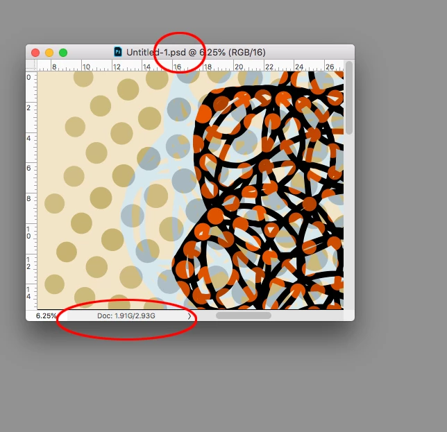

    Maybe you can confirm, but it looks to me like the 2GB limit is the canvas size—the first number in Doc Sizes. So I'm not sure there would be any need to save a 7920x7920 16-bit image as large format. This file saved without a problem as .psd even though its layered size is 2.93GB.

    There are clues in your screen shot that help tell the story of what is going on here, and how to possibly solve it.
    The magnification of the document in the screen shot is 12.5%. That's very shrunken down, suggesting that the image has very large pixel dimensions. Is it more than 10,000 pixels on a side? When I play around in the numbers, I can start to reach your file size by setting up a 15000 x 15000 pixel document, and then setting it to 16 bits per channel to double the file size, and the adding a few layers of pixels.
    But it still isn't enough, the Photoshop file is under 2GB. Seems like it should be able to compress down to...wait a minute, are we really dealing with a Photoshop file here? We should check. Referring to your screen shot, your filename ends in .tif. It's a TIFF file. You're talking about Photoshop file sizes, but it isn't a Photoshop file. It's a TIFF file. This is a crucial detail.
    I go back and Save As to TIFF, making sure to select Uncompressed. Aha...now Photoshop complains about a file size over 4GB. I go back and save as TIFF with LZW compression, and this time it's 3.9GB. I try again with TIFF using ZIP compression for both the document and individual layers, and now it's 19.1MB. (Yes, that seems small but my quickie test doc has lots of solid areas, ideal for ZIP compression.)

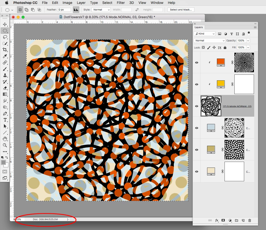

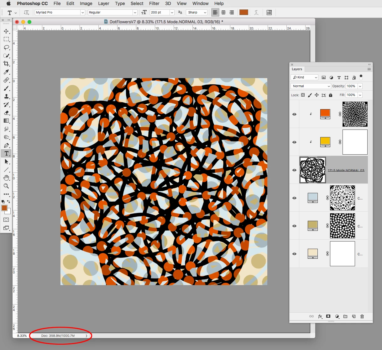

    I can get the OP's flattened print size (the first number in the Document Sizes box in the lower left corner) of 358.9MB with a 16-bit, 22"x22" doc at 360ppi—7920x7920 px.
    The layered size (the second number in Document Sizes) would include pixels outside of the canvas. In this example my layered doc size is just under 1GB
    If I trim or crop to the canvas the layered file size drops in half to 525.0M (358.9M/525M)

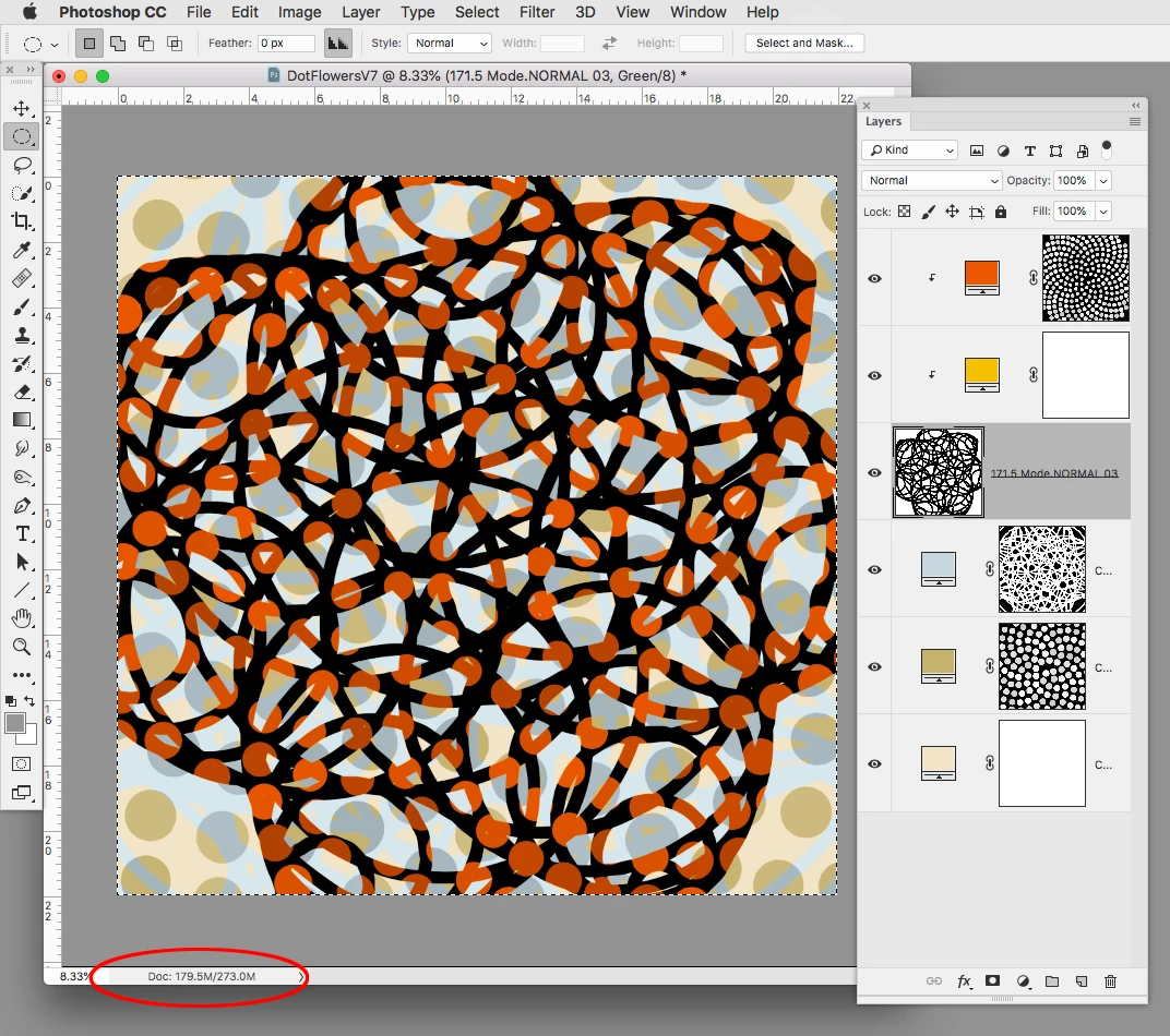

    If I additionally convert to 8-bit both the flattened and the layered size are again cut in half to 179.5MB / 273.0MB
    If the image is headed for commercial print it would be worth considering working in 8-bit—no offset press can print 16-bits.
