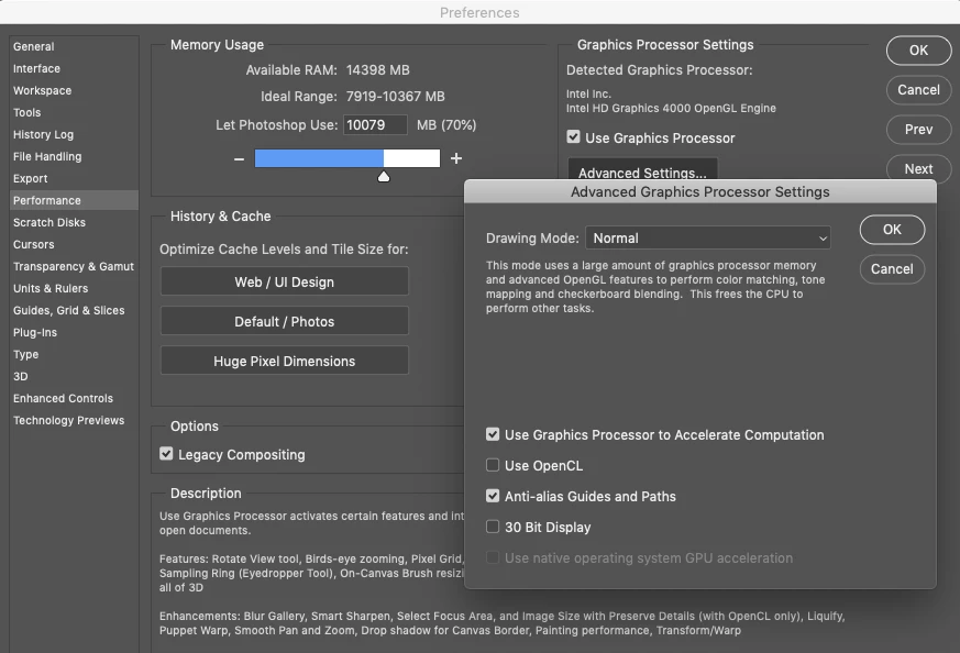

You can dial back the Drawing mode to Normal in the screenshot. Also try the other setttings that I use.

Checking Legacy Compositing worked. And when I unchecked it again, things still seem to be working. Thanks!
