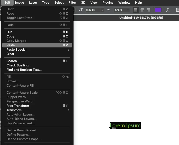

Works fine here:
  1. Copy something to Mac clipboard.
  2. Select Text Tool (type T key).
  3. Click inside the document on (in this example) the background layer.
Paste is accessible.
I have no idea what you're doing. But the above works.
IF you do not have step 2 above, yes, Paste IS grayed out.
