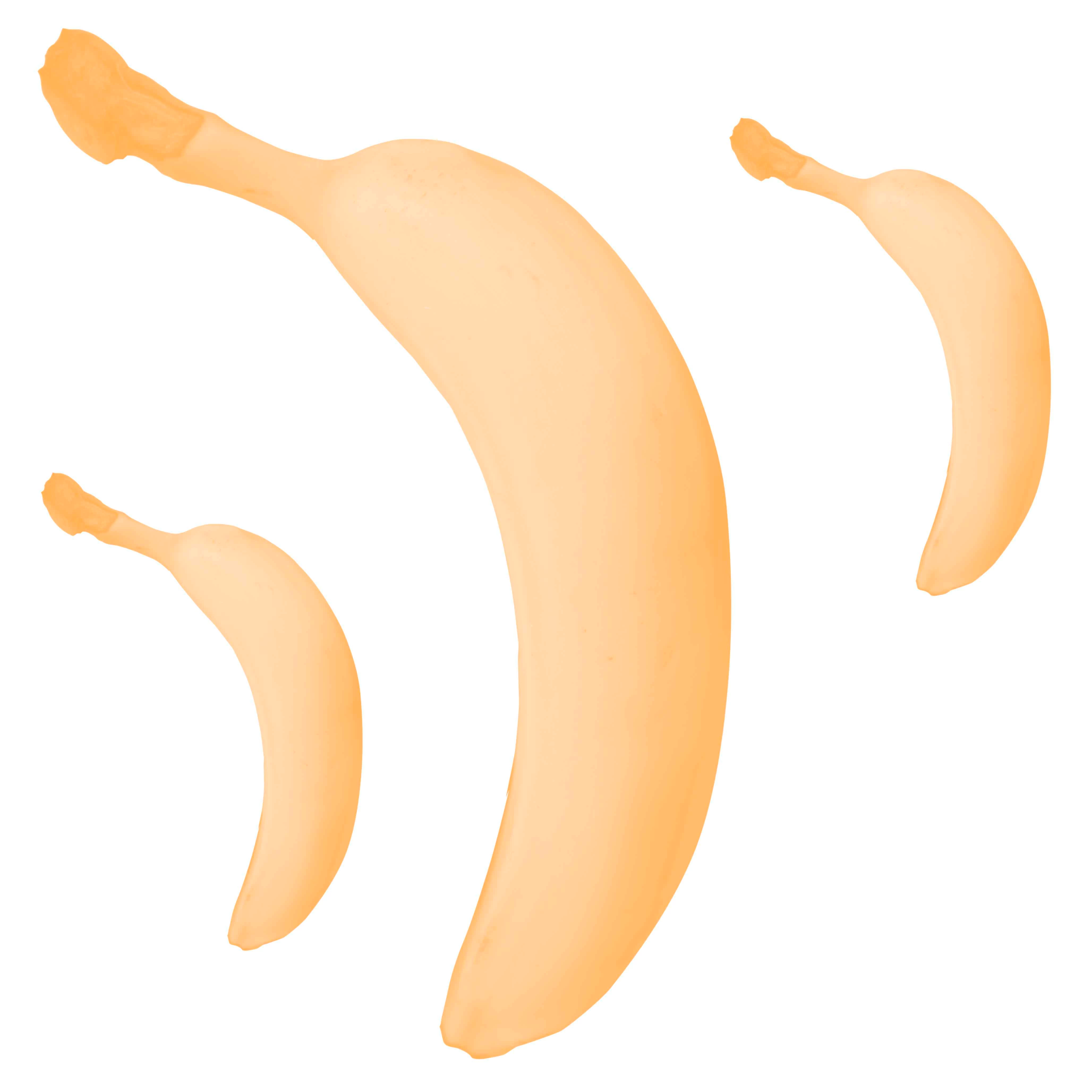

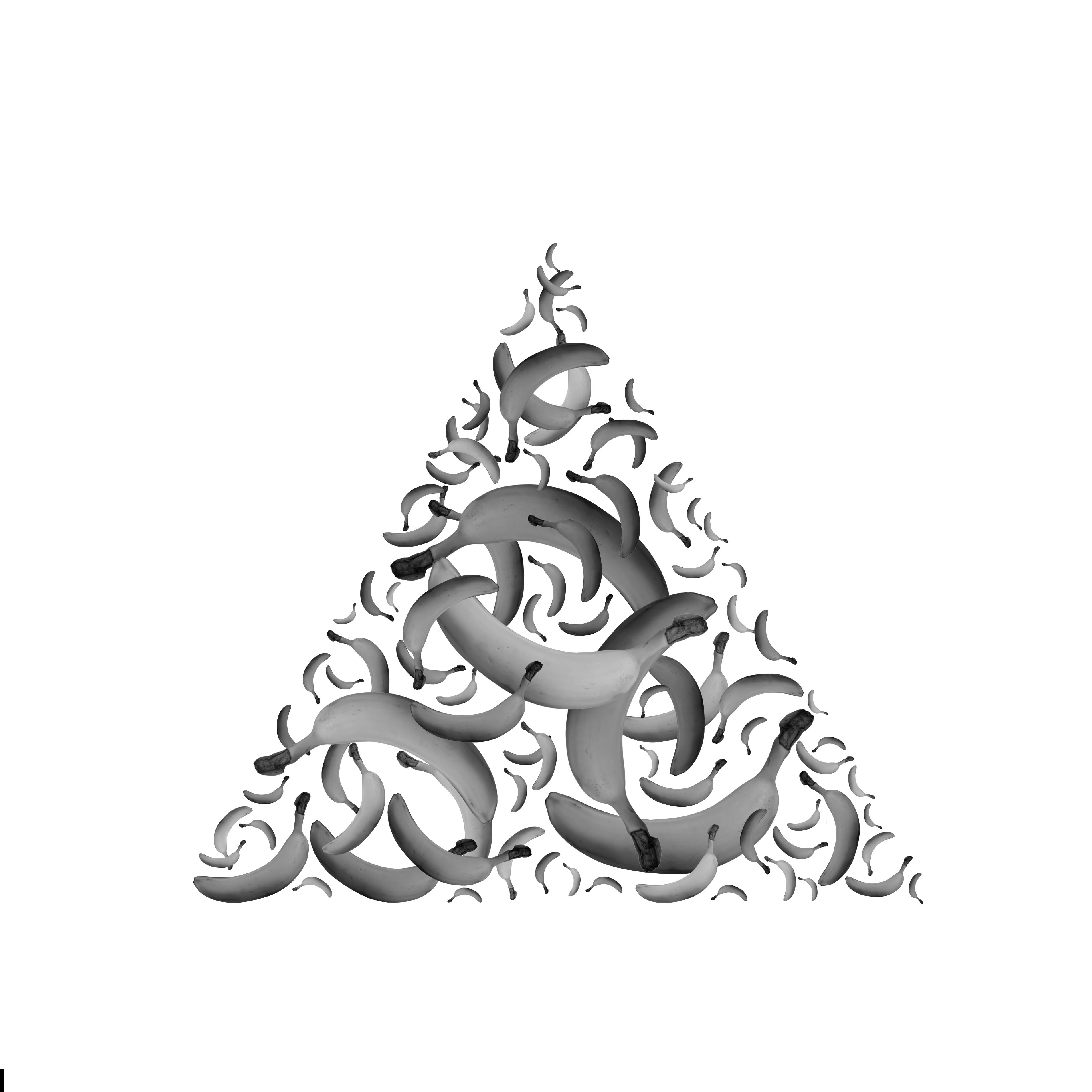

Hi everyone, I wan't to fill a selection, for an example, a triangle with the bananas that I have photographed on a white background and cuted it out. I am doing this manually, but its really time consuming. Does anyone knows how can I speed up this process automatically? I've tried to fill this selection with "shift+backspace" shortcut, to fill it with a pattern that I've made with ''define pattern'' option. I've tried all the scripts ''symmetry fill'', ''brick fill''...doesn't seem to work. I've also tried to make a brush out of the cutout photo of banana, also doesn't seem to work. A brush made out of a cutout photo becomes transparent, and I don't want that. Does anyone knows how can I fill that triangle with a lot of those same cutout photos of a fricking banana? I' am working a few days just to figure it out.
I've uploaded how I've done it manually and I just need to make more of these, quicker.
Thanks 🙂
