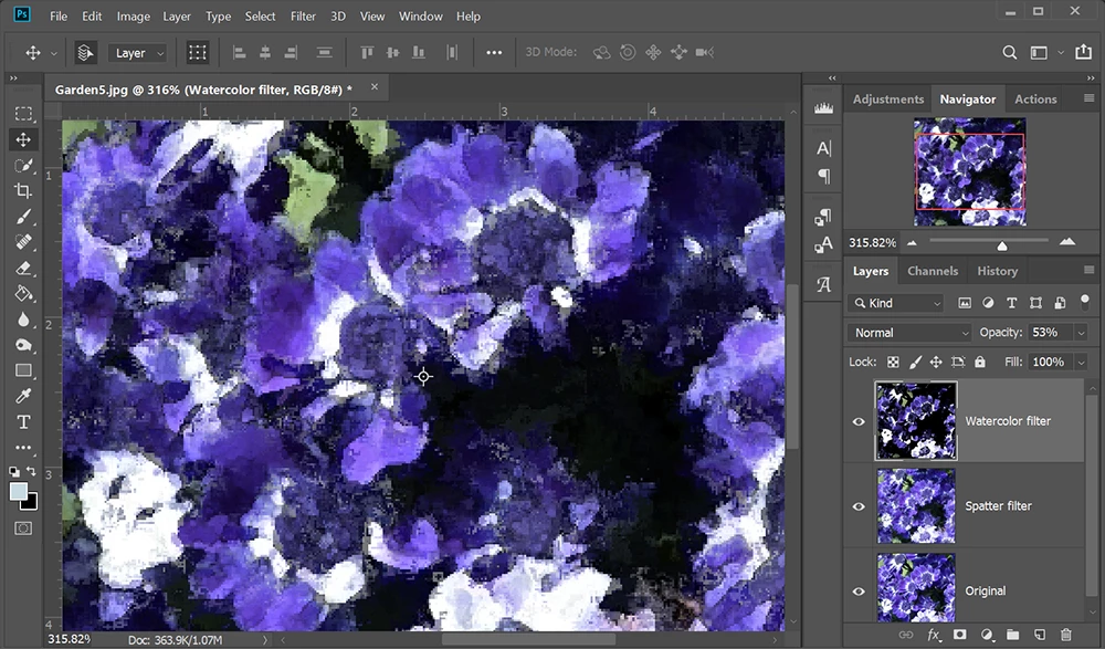

May 2, 2023
Are you working with a locked background layer?
Double click to unlock layer and name it Original.
Ctrl + J to duplicate layer.
With topmost layer selected, apply Filter Gallery.
Repeat as needed.
In this example, no Smart Objects were used.  I stacked filtered layers (Spatter & Watercolor) & adjusted opacity to produce an impressionistic effect.
