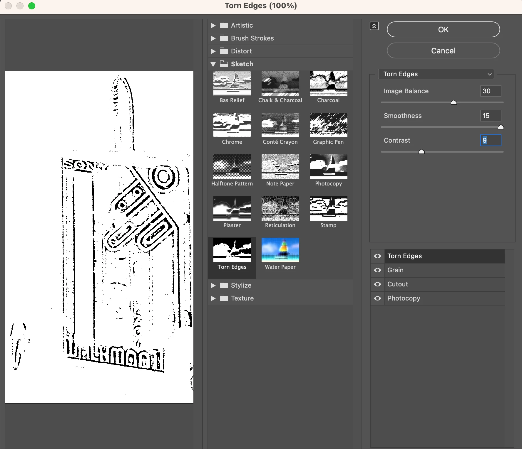

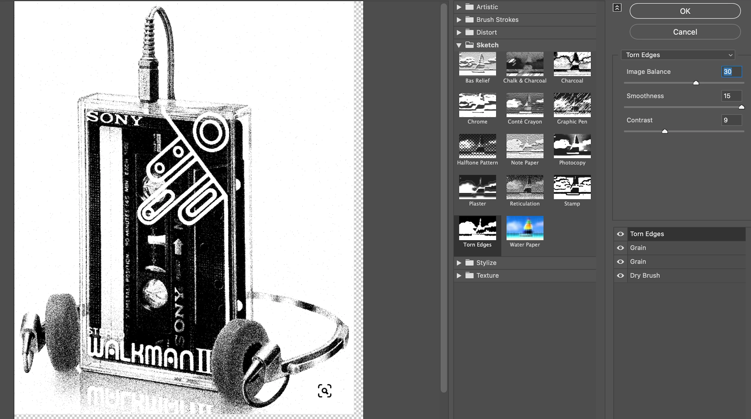

Hi people!
I need your help. I canceled my subscription and then i renewed it.
But now, the filter gallery isnt working like it did.
I show you to screen shots, as it was and as it is now.
What do i do wrong?
Last month, when i opened the filter gallery , i had a balanced preview and could operate.
Now, with the same settings, everything ist very flat and white.
Also im agetting the embeed color mismatch , with the same pictures, which werent a problem earlier. 😞
i would really appreciate some help from you guys!
have a nice day,
Lisa
Correct answer Jeff Arola
Every filter that is applied blends with the other filters below it, kinda like have layers with a certain layer blending mode applied to each layer, so even though the top filter may be the same, having different filters below means the top filter is blended with the other filters and produces different results if all the filters and settings are not the same.
Jeff Arola
June 16, 2023

Jeff Arola
June 16, 2023
 Each screenshot has different filters applied.
lisah69196312
June 16, 2023
really? But its twice the torn edges filter? Even when i change filters, its always that flat.
Semaphoric
June 16, 2023
But each Torn Edge is just at the top of the list, with three other filters stacked up below it, and the other filters are not the same in the two images.
