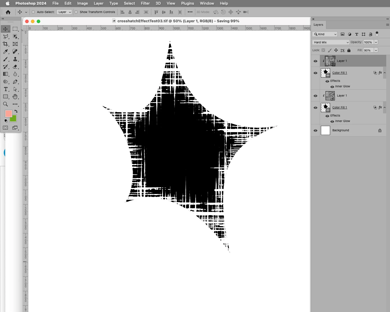

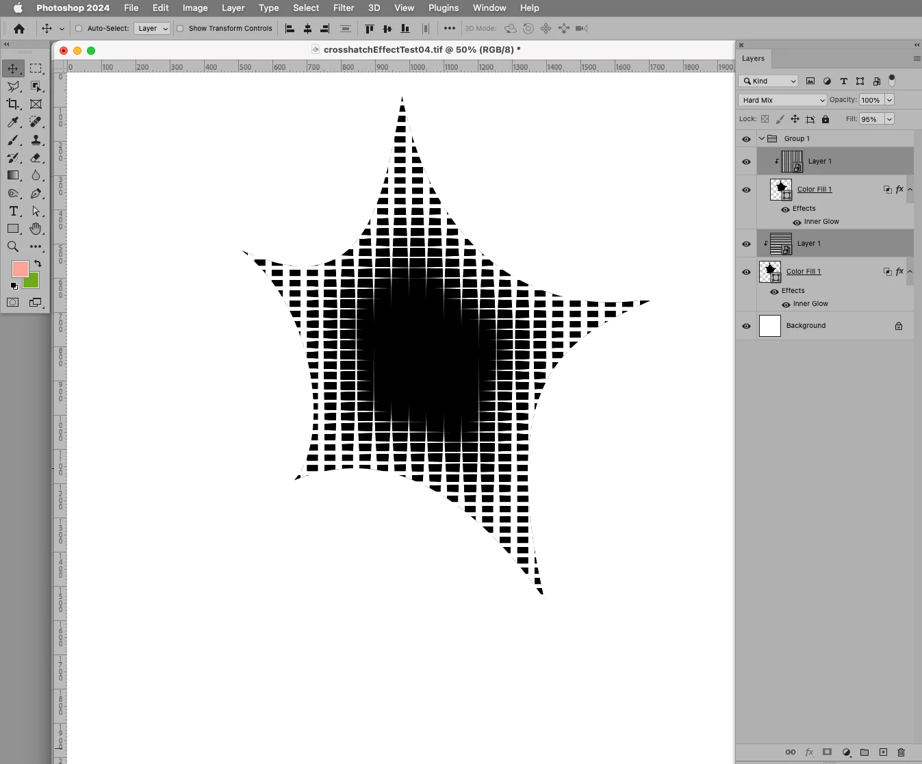

For increased control one could split the vertical and horizontal lines into two Layers.
And if you actually want regular stripes that’s perfectly possible with a Hard Mix-approach.

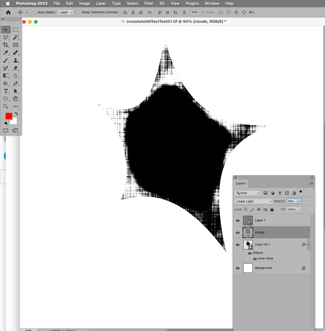

September 11, 2023
If you want to add additional randomness the Filter Clouds might help.

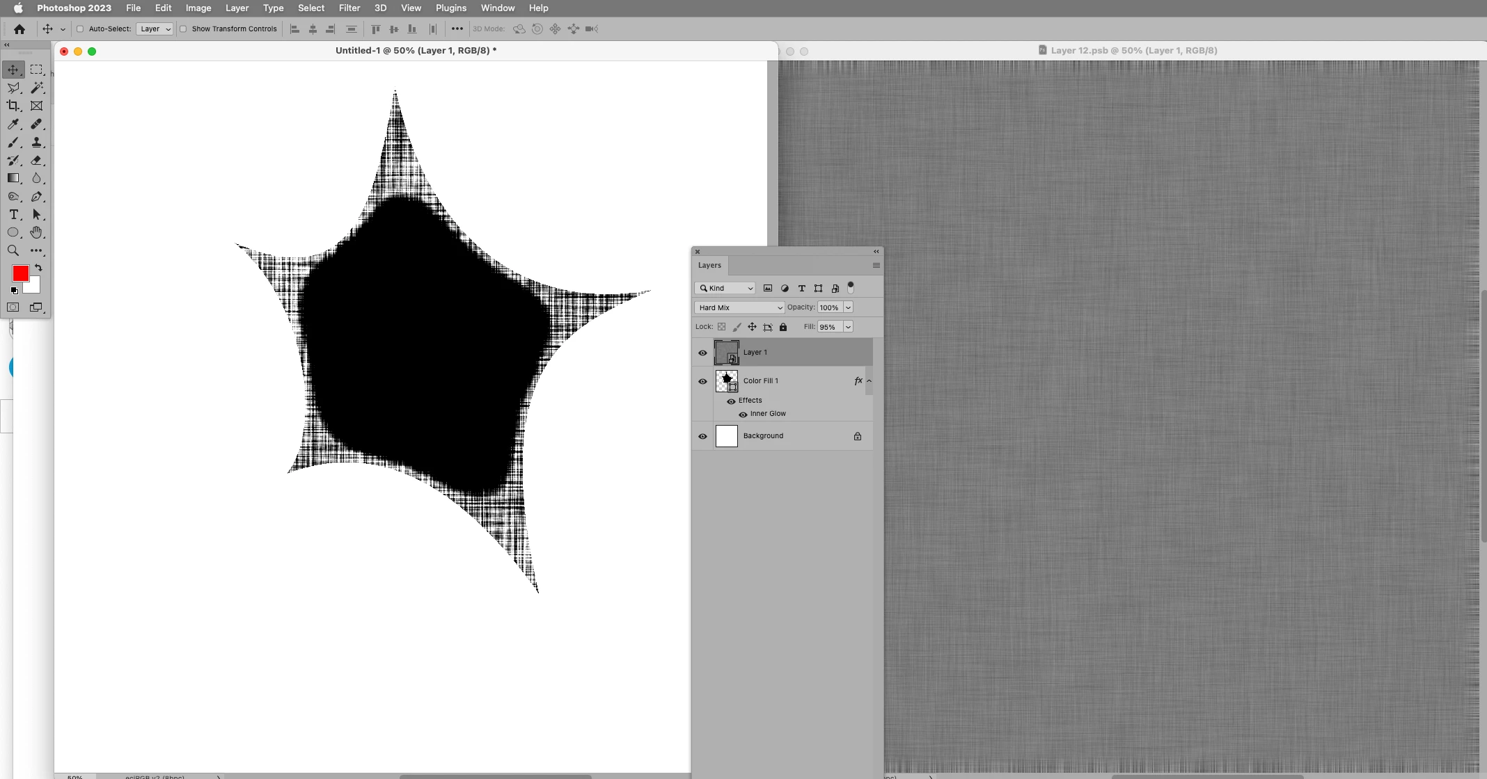

September 11, 2023
The Blend Mode »Hard Mix« might just be your friend …
