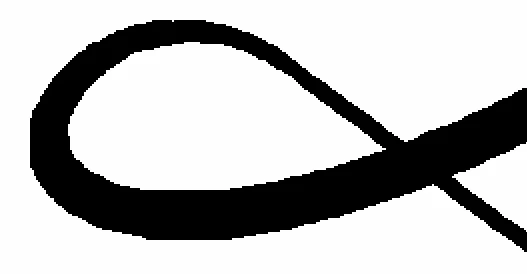

    This is a pencil line zoomed to 200% so we can see the pixelation.

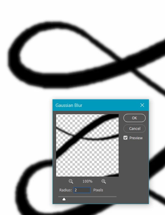

    Gaussian Blur (value 2.0)

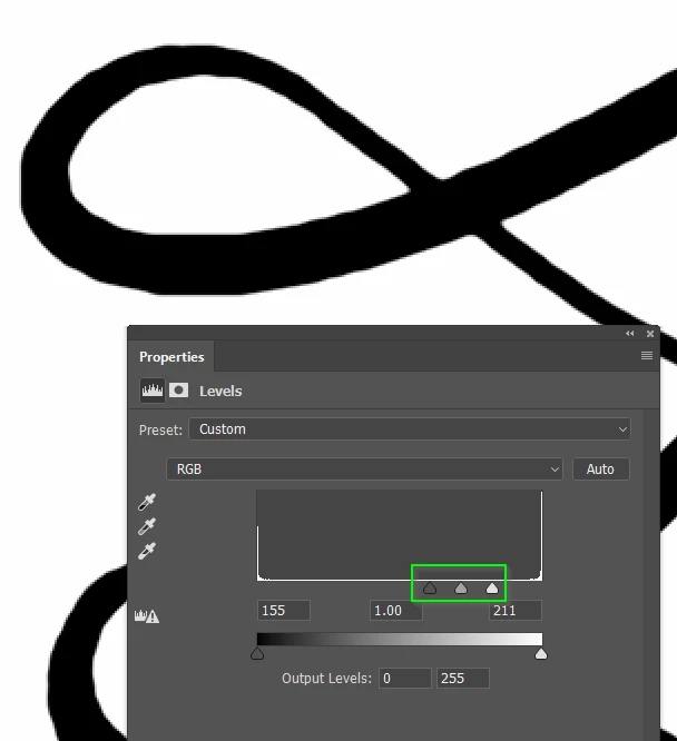

    And Levels to harden up the line again.

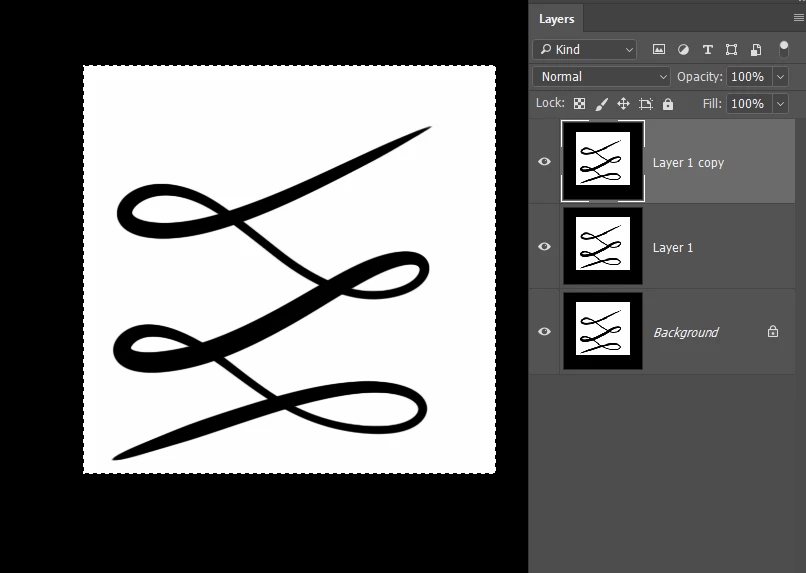

    OK, the same layer copied a couple of times so we can try different methods.  I have saved the selection so I can repeat it.

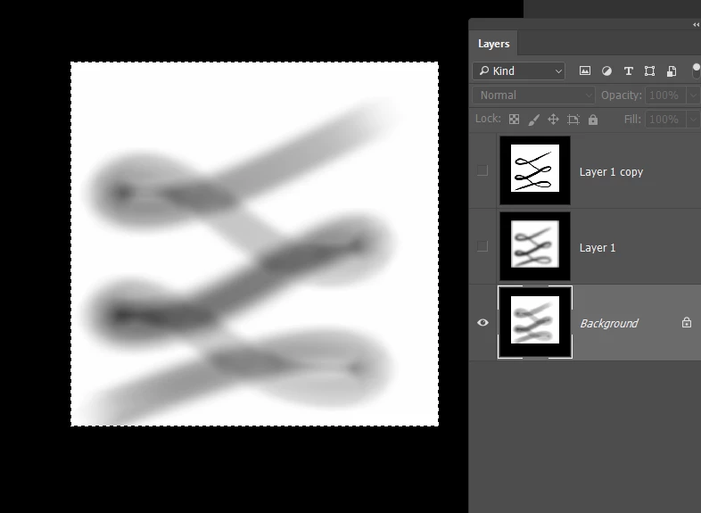

    Gaussian Blur value 10  (the black background is 600 pixels square)
    Lens blur with the same selection in place
    And after OKing it
    It works on things like skies where you want to blur a banded gradient without making the edges go thin.  In fact it blurs the inside of a selection, but not its edges.
